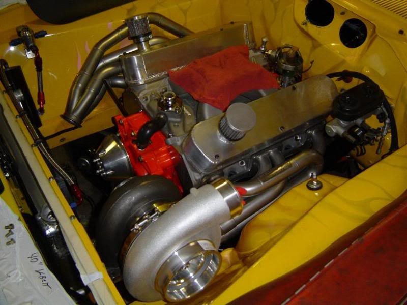

Aaron, here's yet another picture of our intake and exhaust:
I am apprehensive that the long runner intake may not work well under boost (was told that by a turbo "guru",) and am also wondering if that
l-o-n-g header might have too much area externally, and lose too much heat through the walls, before the exhaust gets to the turbo...
I might be interested in buying your modified stock exhaust manifold, if it's for sale, just to try.
I wish I knew what the Hell I was doing...:angry3:

Bill thanks for the kind words I can only hope all my efforts pay off in the end I just got my frame ties today so for the next couple days I'm going to be working at getting that price of this madding puzzle together then I can start with the roll bar and once that's done I can start putting it back together I post some pics of the intake on and the Turbo and waste gate attached to the header:cheers:
Aaron
Aaron
Aaron,
Thanks for the new pictures! That whole thing looks really nice and workable to me! Tight packaging, and a really short path for the exhaust to flow from the head exhaust port to the turbo; that's gonna make some formidable boost, I'll bet!
This COULD be the first Slant-six-powered A-Body in the nines!!!:blob:
That is, unless Mark gets really serious... LOL!
Are you going to get your headers ceramic coated, or wrap them, or leave them "natural"???
Keep on keepin' on! You're doin' GREAT!:cheers:
