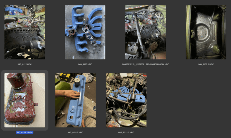

First things first - getting that new gasket on the exhaust manifold and reinstalling the carb.
Next up while it was off was to start cleaning up the valve cover with some fresh paint.
Also noting the rotted repair of the spare tire well. Not sure what that foamy patch stuff is.

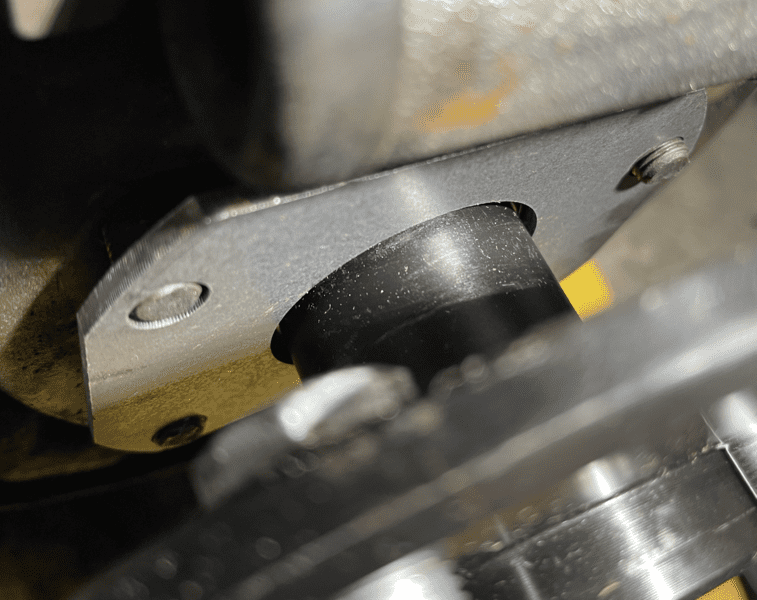

Now, digging down knee-deep into the suspension and brake upgrade so I figured I’d try to track some of my progress here with a new thread
All the parts are from Dr. diff, including 13 inch front disc conversion from the previous 9” drums. Since I’m already getting into the brakes I figured the suspension was the easiest obvious step to do along with it so here’s some progress
finally got the driver side installed after repeatedly taking off and putting on the hub because the adapter brackets require you to basically pre-hang all of the bolts that connect to the caliper. I’m a little bummed at the paint chipping off so easily from the caliper, but the rest of the parts seem pretty good quality.

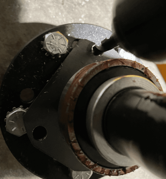

Opposite side was a bunch more trouble. The adapter plate holes were not true center when inserting the bolts so I stripped one. Fortunately the spindle holes weren't stripped. Had to go to the store and buy some new 1/2-20 bolts and decided to ditch the Allen wrench style bolts for these instead. Drilled out the plate holes just enough to get both bolts in… 2 hours down the drain but it’s ready to install.
At least now I know the process to install the other side so should be much faster

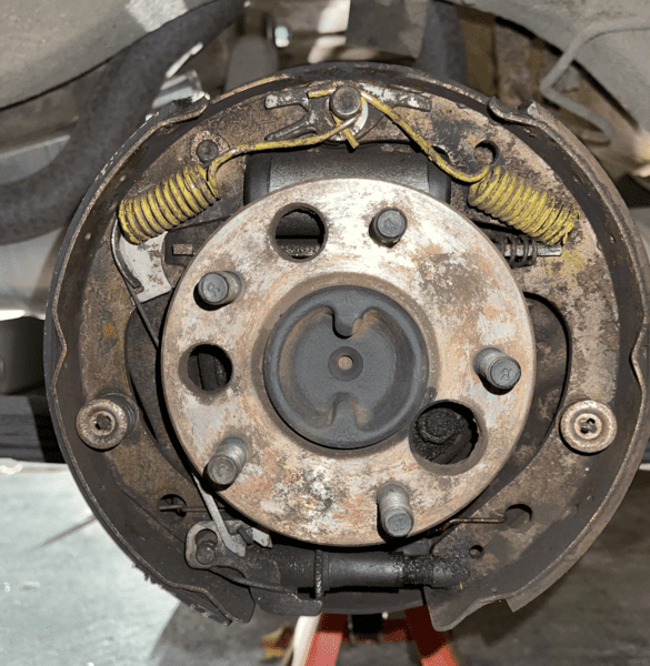

Latest updates:
While i've been on break for holiday I got the chance to do a couple things on my list:

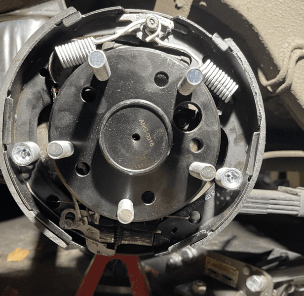

1) replace rear axles with Dr Diff's 5x4.5 BBP for my 7.25" rear end
2) rebuild the drum brakes
3) swap in new shocks
Before shots

Ya, I figure the drill alignment for those plates must just be off a little. No one else makes these parts so I’m grateful for dr diff. My wife wasn’t so much lol she was pulling a couple aluminum shards from my feet because my dumbass went out in the garage barefoot without vacuuming them up but it’s all good.

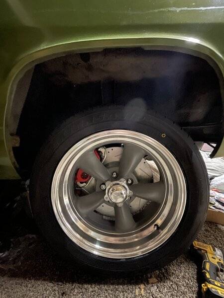

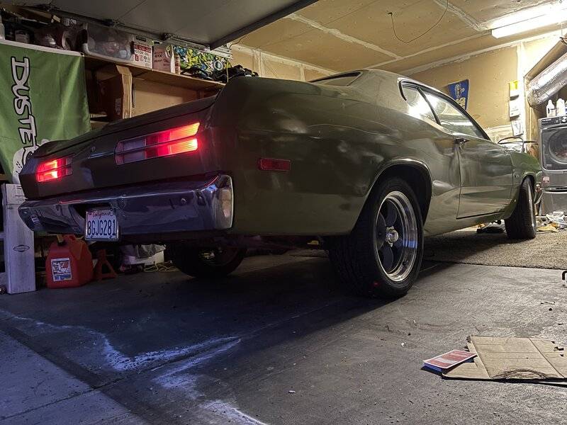

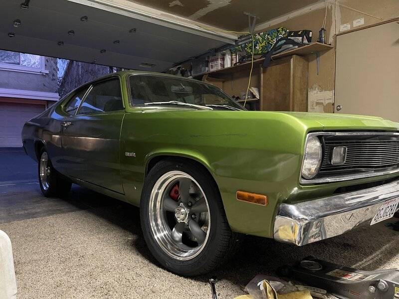

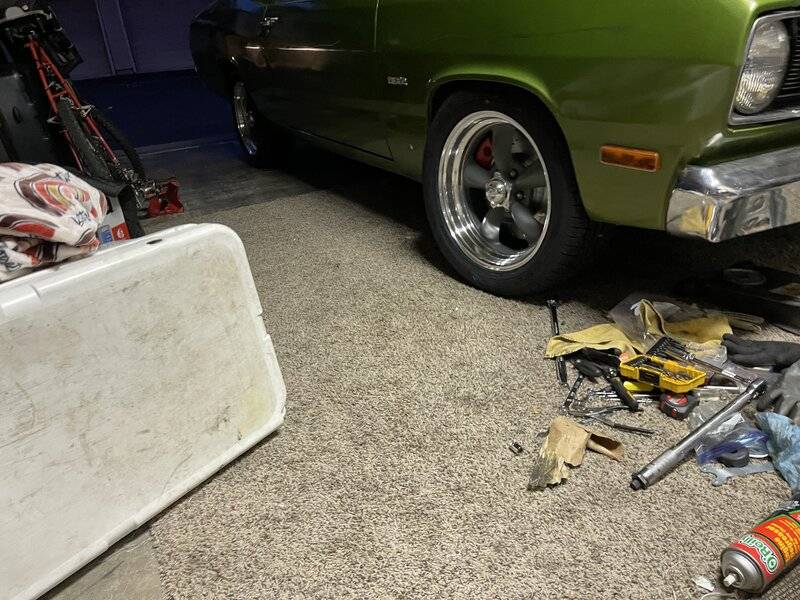

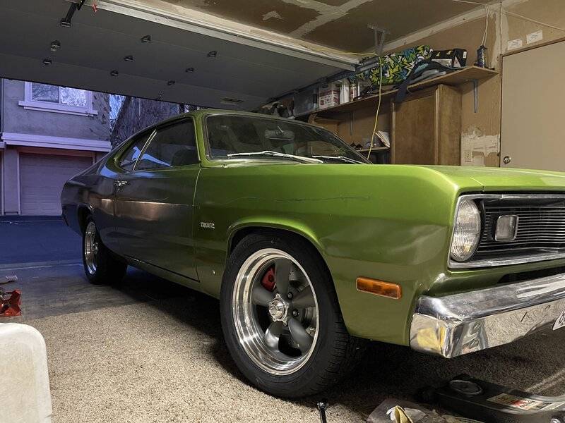

Test fitting the new wheels/tires , can’t wait to get back to work on this.
Front -17x7 torque thrusts with 225/50/17s
Rear -17x8 torque thrusts with 255/45/17s
Update:
Bled the brake lines. Filled up the gas tank and tested the new sending unit gasket that i installed before doing the front end rebuild. Looks like it’s holding the fuel well with no leaks! Honestly terrifying adding fuel back in knowing I might have to drain it quickly again
Then got the brake pedal switch readjusted. That is a PITA to get to the bolt! Pulled the car out and turned. Front tires rub a bit so have to raise the torsion bar tension closer to where it was before I dropped it down.
Overall happy with the work done and can’t wait to see what happens with the brakes at speed
Oooofff! I did the same thing when I installed my wheels. Had to roll the lip over and trim the corner to clear.
Wheels look great though! Car is looking good too!

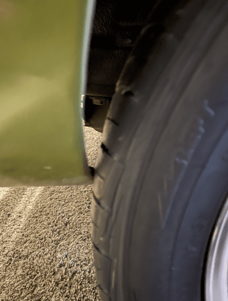

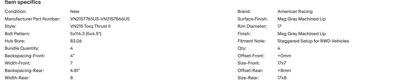

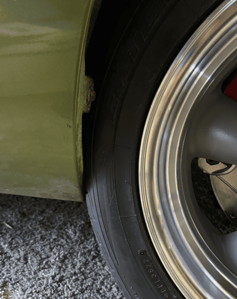

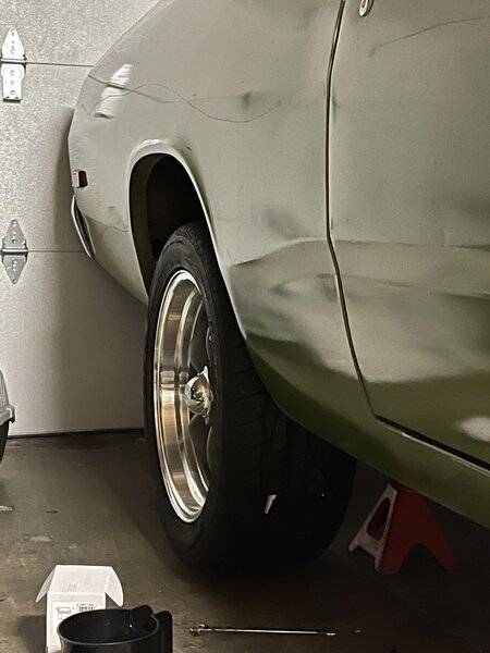

Welp kinda stuck. I feel like i've did extensive due diligence trying to make sure I double checked everything before buying these tires and wheels, but my human error bites me again.
So first off, my cobra brake kit increased the track on my front mounts and even with a 17x7 (0 offset) wheel and a tire profile I liked it started to rub on the front and rear of the wheel well at turn. I only calculated how the diameter of the tire would affect the top of the well so... bummer
My options it seems are to get 2 new tires mounted on the wheels in the front moving down from 225/50/17 to
225/45/17 - yields me .89" decreased overall diameter (.445" per side)
or
225/40/17 - yields me 1.77" (.885" per side)
I don't really know of another way to get the car to turn without hitting.

Not sure what to tell you in regards to using the wheels you bought, but generally you will need some positive offset on the wheel. I run a 245/45R17 on a 17x8 wheel with +30mm offset and have little to no issues.
yeah I think I'm gonna have to swap the front wheels out
Looks like there's a 17x8 option with +25mm offset which yields me half an inch more backspace than I have now. I think that wheel plus a 225/45R17 will work best.
Gonna cost me $750 or so to buy the 2 new wheels and 2 new tires, but I think it's better than trying to get these 17x7s to work for me.
