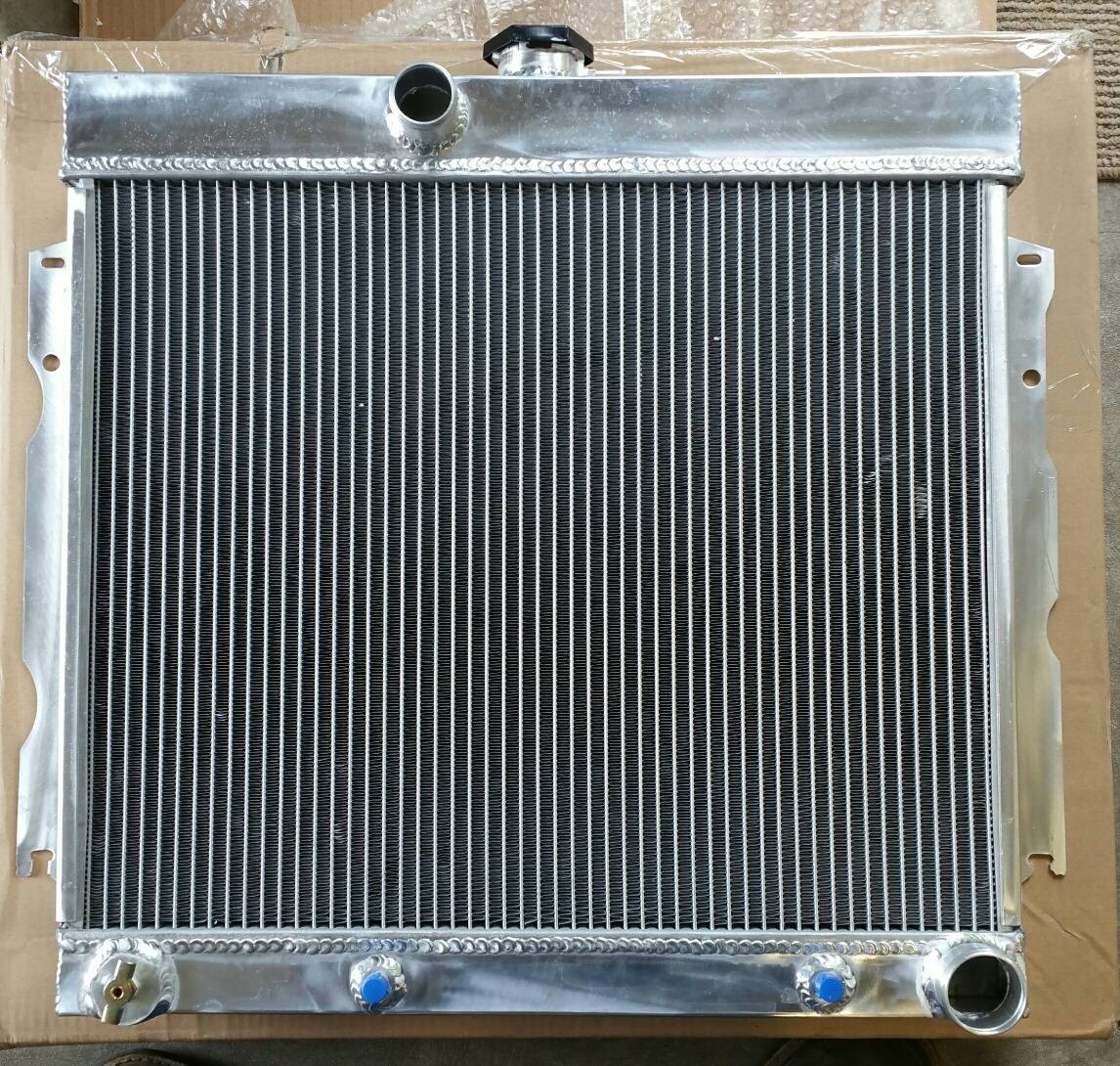

Our custom Aluminum radiator for the 65-66 Dart Magnum swap. The lower radiator port is on the passenger side to match the Magnum water pump and we left the upper port off center so the hose will bend where the a/c bracket use to be.
The radiator is a 2 core and rated to 350 HP, perfect for our build and a steal at just $250 retail.
