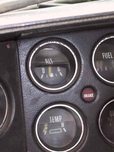

Now I’m reading and some say it’s too high and will burn factory ammeter, is that so? Should I get different alternator or voltage regulator? Thank you
Most Plympouth/Dodge ammeters have "alternator" on the gage face.
That can be a little misleading.
These ammeters shows the amount of current going to or from the battery.
If the battery needs charging it will show current flowing to the battery until it is charged.
If the alternator can't supply the power, or enough power, the ammeter will show discharge.
That's it.
The meter shows up to 40 amps in either direction.
If you see it getting close to either extreme, there is problem. And if it pegs either way there is a Big problem.

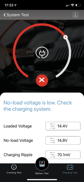

13.5-14.5 has always been my rule of thumb. Chart shows I'm in the ball park.
I think in the 70s with the isolated field alternators and transistorized regulator they tightened up the spec. That might put your rule of thumb even closer.

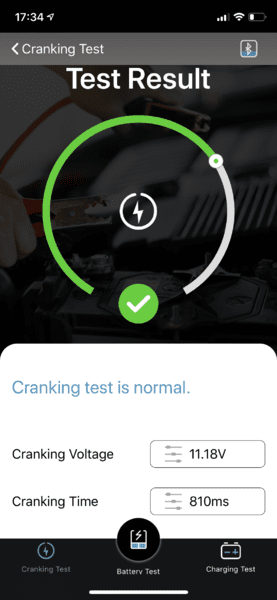

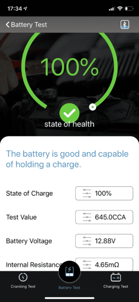

I think my multimeter is bad... looks like it shows 14.4-14.8 charge ( which fails according to battery tester Lol )
