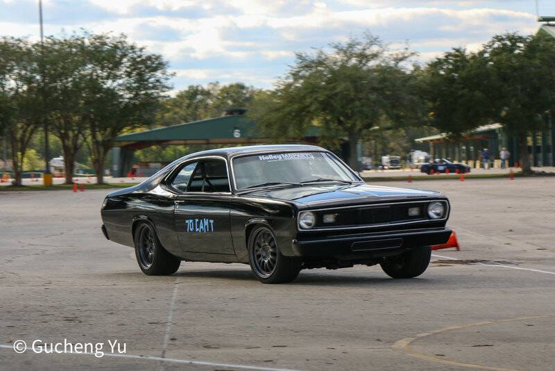

I run a staggered set up on my Duster, but my 18x9's up front have a +35 offset and my rear wheels are 18x10 with a+38 offset. So it would be easy to run the same wheel/offset front and back on any of the Sport body cars with a B-body rear axle.

I just got a new set of wheels in late fall so I can have dedicated wheels for my autocross tires. They are Kansei brand Street Wheels | Kansei Wheels
I'm running 18x9 and 18x10.5 (offset leafs and sliders, a-body rear)

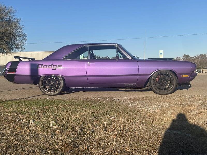

I plan on running 18" wheels front and rear. I really like the look of wheels like Bergman has on his Purple Dart. I believe some are made for the newer mustangs.
Really hoping the spring relocation helps with wheel variety.
Thanks again for your help @72bluNblu
you are correct, it is an A-Body 8 3/4 with the spring location kit and BBP.
