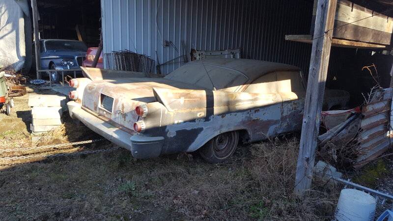

The place I got my '57 Custom Royal Lancer, the parts car '57 Royal, also my '58 Plymouth Suburban wagon and parts car '57 Dodge Suburban wagon, and the '56 DeSoto Fireflite... he also has like 20 or so '58 Dodge's.

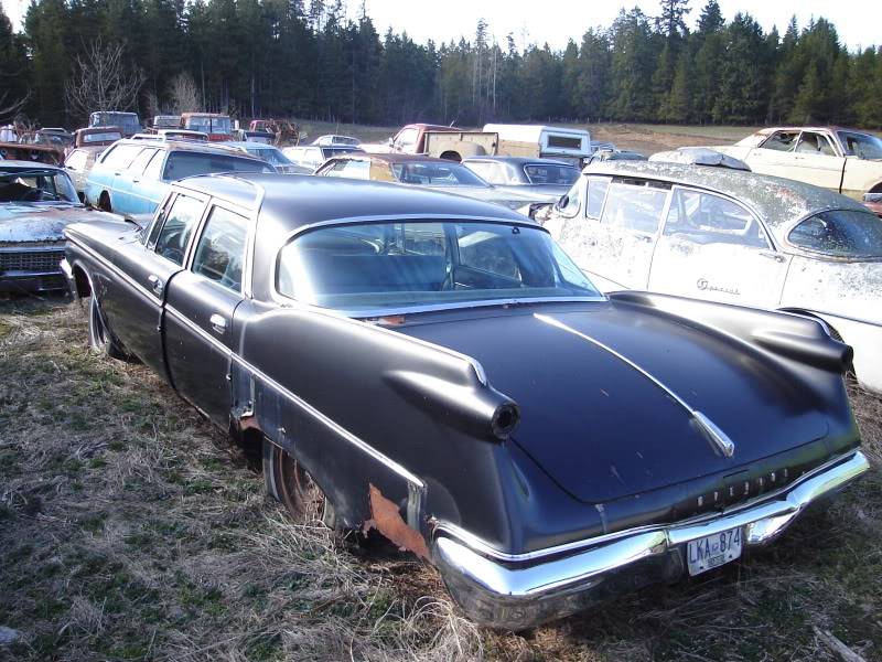

If I wasn't already overloaded with projects, that '58 Chrysler would be my choice.

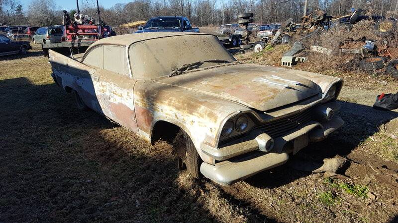

Yes! I feel truly blessed for the opportunity to purchase. It is so cool, and he was pleased that I bought it.

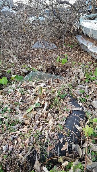

Unfortunately, windshield in car is destroyed and the windshield that he got with it was cracked, so I need to find another.
It was in a crate outside forever, crate all but gone, windshield sank into the ground.
I dug it up today and what a disappointment.
Previously, I pulled the plugs, filled the cylinders with MM Oil, and put the plugs back in finger tight.
Today was warm, so I put a breaker bar on the crank, couldn't turn it, stuck the jack handle over it and it turned no problem.
It's difficult to turn because it has compression, it was squeezing the oil and air out from around the plugs.
I pulled a valve cover and they are moving along.
I pulled the carb, it's clean inside but the bottom butterfly is stuck. I had sprayed it with PBB back then as well, I think that's the puddle in the intake, but other than that it's clean down there.
Need to find the correct rebuild kit. I'll also test the fuel pump, it has new plug wires, cap/rotor on it from before it was parked.
Car sat 30+ years and I can't get over how every bolt and fastener just comes right off.
The distributor advance line is metal, tiny delicate, typically a rusted mess that refuses to budge, twists and crimps itself into an effing mess, came right off.

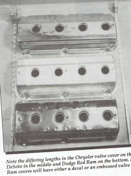

Don't know the numbers, but a tape measure comparison of the length of the intake should suffice to let you know if it is a Dodge intake. Dodge hemi/poly motors are noticeably shorter than either DeSoto or Chrysler. Then measure width and compare it to the width of your two barrel intake for whether it's a raised deck or not. Early Dodge hemis were short stroke, low deck. 56 and later 315 and 325 motors were long stroke (3.80 inches) with a raised deck. Low deck and raised deck Dodge intakes are different, as I found out a while back when I was trying to sell a tri-carb Dodge intake on ebay.

From Tex Smith's book, How to Build Chrysler Plymouth Dodge Hot Rods, this photo shows the length difference in the valve covers of Chrysler, DeSoto and Dodge hemis:

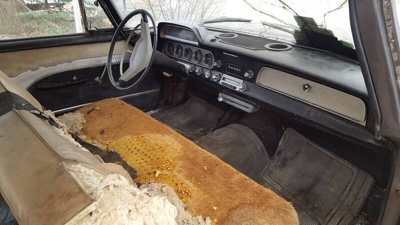

Short term goal is to make it go/stop and make the interior suitable. The seats seem to disintegrate in these cars.

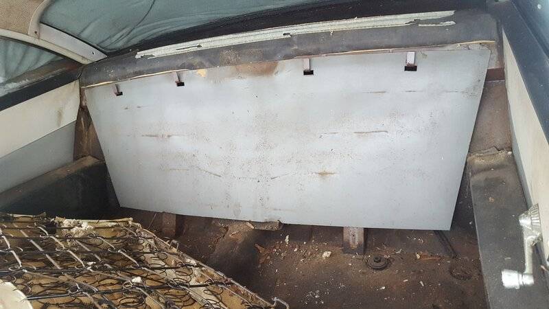

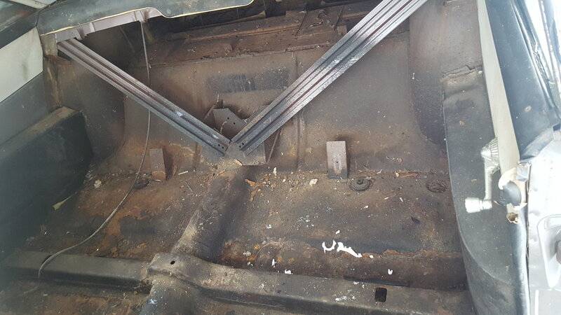

Pulled the backseat, could be worse.
Rear panels are in vgc, I see solid body mounts as well.
There are two on the outside in the same position that are rusted out, but I can fix that rear section with some sheet metal.
