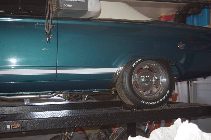

Got one side done with the 3M film along the lower edge and ran out :(... so what do you think... with our without the stone guards... I spent way to much for these perfectly polished items so it is killing me not to use them....
Stone guards would be my choice, just enough to offset the beautiful paint job.

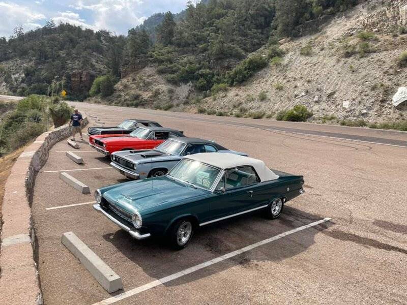

We embark on a 500 mile round trip to a weekend and a show in the mountains in the morning. Coronet, Duster, Dart, 66 Hemi Satellite and a CRV heading out at 5:30 am! Wish us good fortune!

Best Mopar at the Show Low Az show last weekend! Nice 500 mile round trip drive with all 3 cars plus a Hemi Satellite. The Dart only had to stop about 1/3 of the amount for gas as the Hemi!

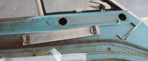

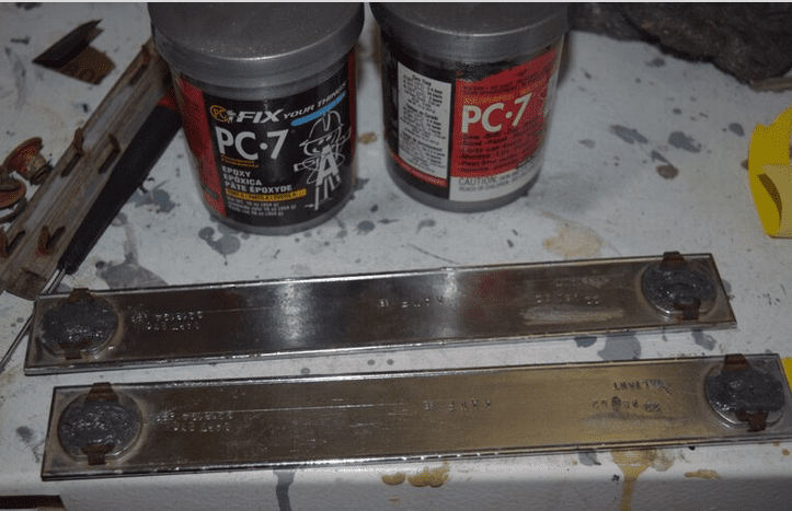

Actually, I do have one question. One the Dart 270 door badge, do the 'clips' that hold them on come off? Or did you break them? I noticed when you went to reinstall them, you covered the clips with epoxy.
