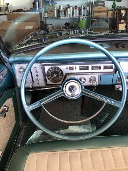

Either the mighty slant 6 ripped the transmission mounting loose and chipped the mounting flange.... or a ding dong forgot to tighten the mounting bolts and one fell out and the transmission flailed around chipping the housing... no one will ever know...... New speedo gear installed to to match the drivetrain... time for a test drive. Note that these pushbutton speedo gears are the same as standard transmissions so Brewers carries a full selection.

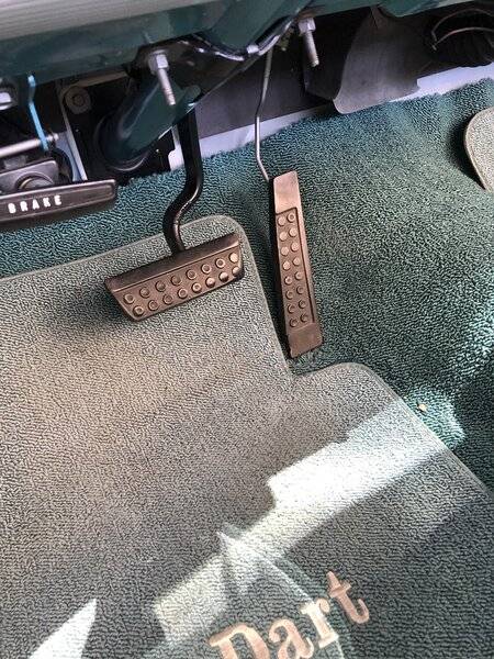

The fine detail honey do list is dwindling. The RamMan booster did come with the correct length rod, for some reason I thought I had the shortest one in it. Not. Perfect peddle height for the disk brakes. Passenger side mirror, you miss that after decades of standard equipment. Toe in set and wheel centered, had not done that since the disk install last weekend. Finally got the correct speedometer gear, dead on at 75mph. Left a little rubber with a /6 before a little cruise with the owner.

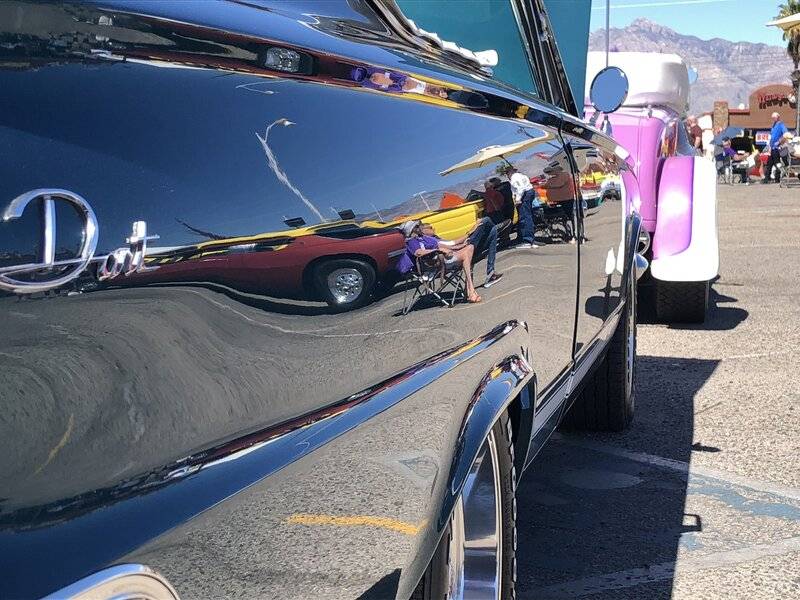

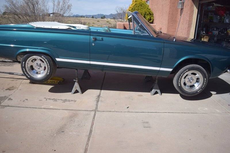

I take it for granted since I painted it but there are days the sun lighting is just right that even I have to say WOW. Southern Polyurathanes Universal Clear.
Car show today in Tucson.

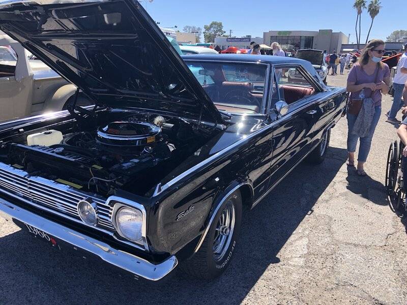

Somebody help me..... the oldest is totally fascinated by a 1966 Valiant and wants it..... another project......
Sigh. Oldest daughter is smitten with a 66 Valiant Signet. Looking at it Friday. Factory 273 bucket seats and console.
Round 4 cummin' up! Don't need TV with Jim on the net. (As a matter of fact, I haven't had TV since 1999.). Jim, it's a small handful of guys like you that keep my hopes up of ever getting into another A-body project again (owned 30+, but not recently). Thank you for sharing your incredible adventures.
I saw your teaser thread about a new resto before I read it here and for whatever reason, I was thinking Valiant. Plymouths for the kids and Dodge's for the parents.
