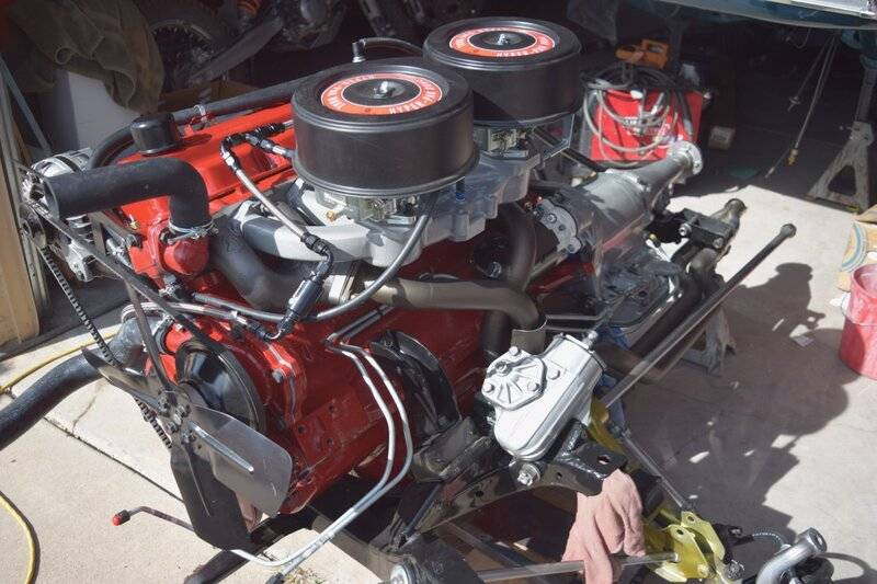

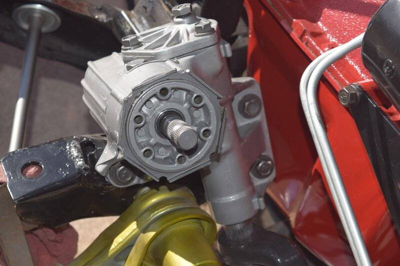

More gymnastics to get it together. Finished up the front steering, torqued and cotter pins installed.... nice and safe for the wife now.... Got a SB oil tube and will cut it off to the right length, if I can ever find someone who knows it.... Lots and lots of small details done and she is bolted up for good!
