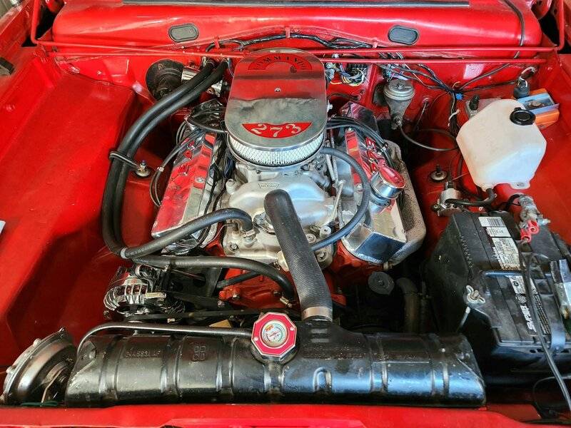

Guys...I just wanted to say "THANK YOo" for all your advice and input in helping me with the rebuild of my '65 Barracuda engine. Everything came out great and I added some spice to it with a Competition Cam kit, Weiand Intake, electronic distributor and Holley 600 4160 carb. We didn't have to bore it or turn the crank, but installed all new parts and dressed it up a little. Just wanted to share a couple of pics of the finished engine. Runs really great too with new stock style Barracuda S exhaust system with rectangle muffler/tip from Accurate Exhaust.
Again thank you for all your help, I really appreciate you knowledge and willingness to share your wisdom.

Thanks for your feedback and info! The previous owner evidently installed a 1967 273 block for unknown reasons, but stock heads for the '65 273. We discovered the block was bored .40 over with regular pistons, heads were milled, and a new valve job. The crank had been turned to .10/.10 and a hydraulic cam set up installed which we replaced with a more aggressive cam set up. Compression is about 9.2/1. We put all new cam kit, rings, all bearings, hi volume water pump and oil pump Just wish I had a sure grip rear diff but for now have to settle for the stock 7 1/4 open differential. Installed new ball/trunnion and u-joint, checked over the A-833 4 speed and all seemed to be good, installed new clutch kit.
Still wondering about maybe changing heads, what do you think. Keeping stock exhaust manifolds cause I can't seem to find a set that fits the 4-speed set up without having to modify parts.
