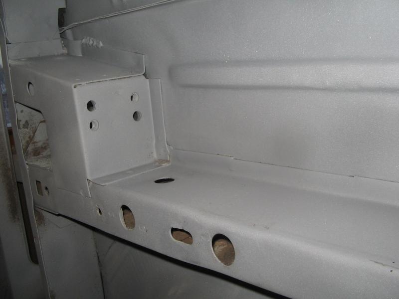

Started to smooth out all the small dents and dings. This will take som time but after 4 hours today I just I have some small places left. The rear right steel section in front of ther rear spring bracket needs to be replaced, It is too much work on in and the isn't som much space.
Anyone having one section for sale? it is the last picture!
