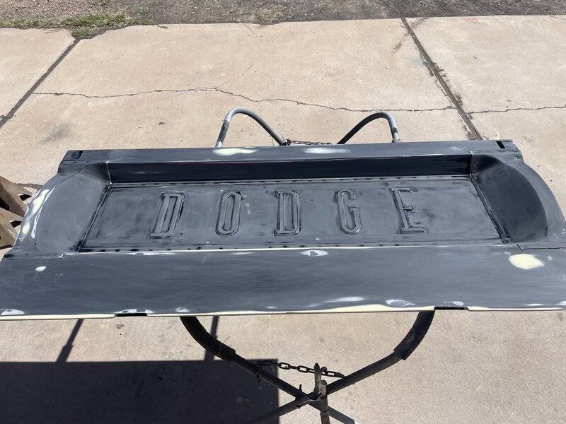

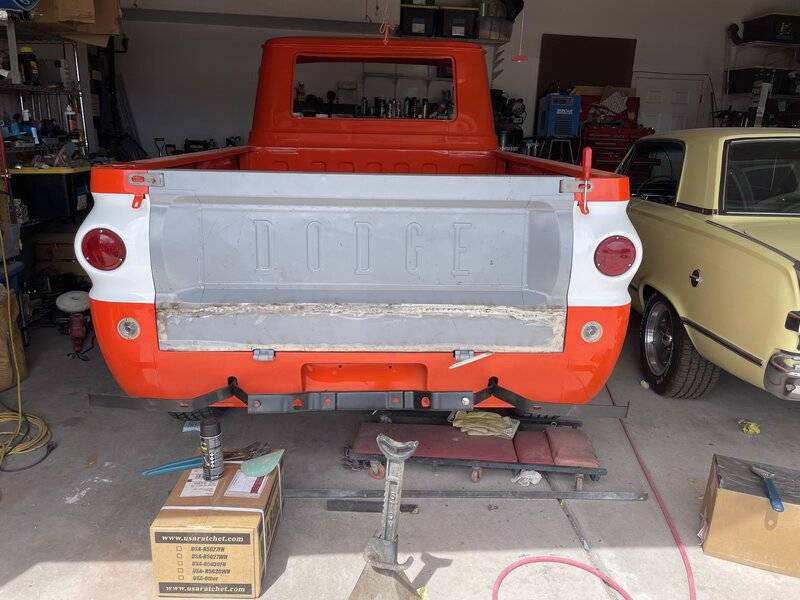

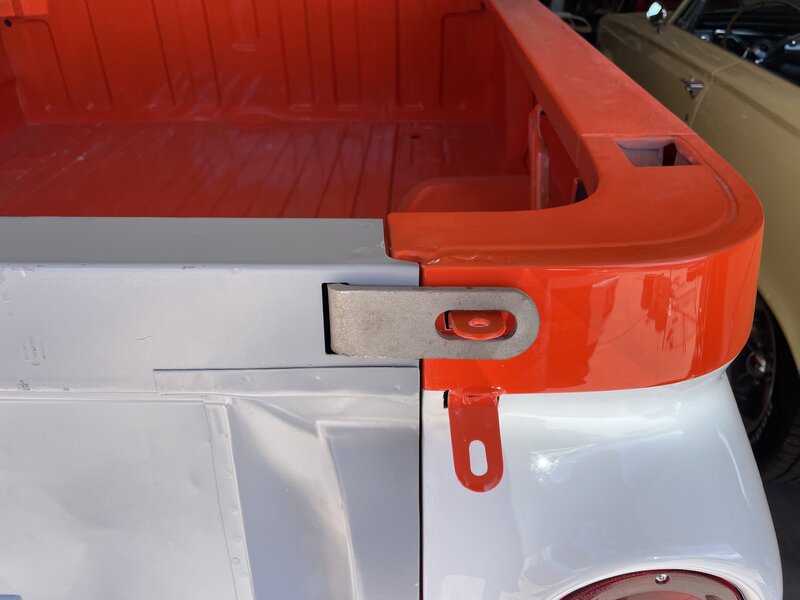

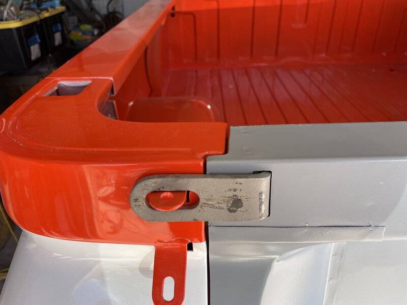

Tailgate is almost fitted. Needs a bit more hammering but I’m beat so time to walk away for a bit before I do something dumb. The 408 arrived today as well, thanks @Johnny Mac.
great gaps as always :thumbsup:
will you move the drivers side tailgate catch outwards a little to centre it over the tab in the body? the pass' side sits perfectly centred and i'm guessing that other side will bug you.

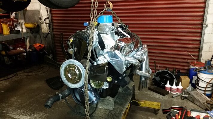

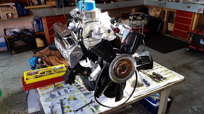

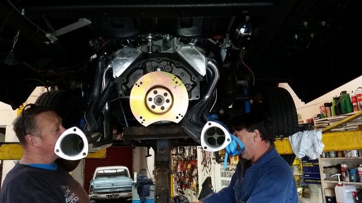

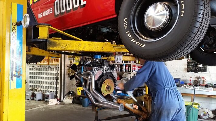

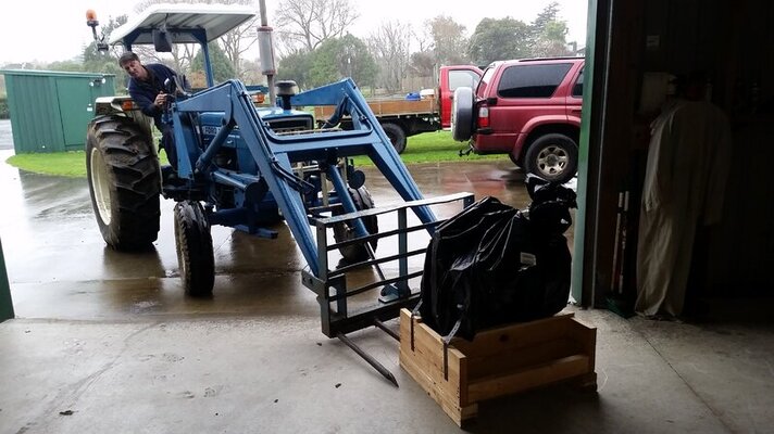

It does fit this way, and it goes in really easy if you take the time to undo the side brackets that hold the engine mounts. Make sure to lube the bolts for re-fitting them. A lift can take a lot of the hard work out of the engine install.

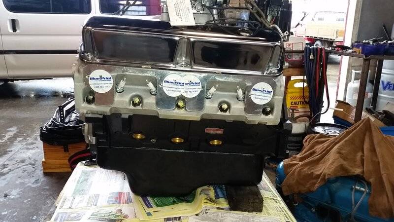

Another shout-out to @Johnny Mac for setting up another member with what I know is a great engine. I am still extremely happy with mine after nearly six years now.
Still getting compliments on how well this angry little beast performs. :lol:

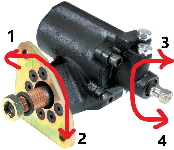

Since I can’t actually make any progress on anything else, and I have parts strung all over the place, waiting for a multitude of things to put them back together why not take something else apart! And of course it’s a search to find parts for these too. Called the@ normal Mopar steering gear places and nobody deals with truck boxes. I looked up part numbers for seals and I can’t find any new old stock so I have some from Grainger coming that are based on measurements. Fingers crossed. Everything else is cleaned up painted and restored. Just need the seals. Also need to either get a U-bolt clamp for an automatic or cut, the one off that has the three speed bracket. Anybody have the correct U-bolt clamp they part with? Interesting these boxes appear to be painted oxide red from the factory.

Those steering boxes are rarer than Rocking-horse scat.....so I have contacted a local machine shop to see if they can help repair what I have as a spare. The bearing faces shown in the picture (your pic with arrows attached) show the most common and hardest part to repair. You need to either have someone build up and re-face the bearing surfaces - then heat treat, or try and re-face the bearing surface to suit the next size ball bearing up - which happens to be 8mm.
I have sourced the ball bearings here - OE size and the 8mm, and will attempt to have the surface re-faced.
The other thing is you may need to make your own gaskets if the originals are worn too much.
...and yes, mine were orange from original. Technology of these steering boxes is from the 1940's......there is nothing out there that is close to a retro-fit in case anyone suggest it. I have spent many hours over the past five years trying to find something close.
The closest I got was a special order reverse direction Vega Power steering box. Still a little bit big, but with soe adaptor plates it would work.

Another helpful hint if you're going for headers..... I just removed the Hooker Super Competition headers from my A100 this past week.
Reason: they take up too much real estate under the lid, and they generate a lot of heat. I swapped out to a set of Patriot Hugger style headers, and so far the heat soak os less, and they run about 40% quieter that the Hookers. The Hookers were also just about touching the side walls of the doghouse, so that was an issue also.
Please consider that when you look at headers....with the 408 power and torque output, the slight drop in scavenging power will hardly be noticed to the average driver. :)

I have been happy with Lares on Conventional Mopar pumps and Gearboxes. But i have had Two Different A-100 boxes done by other vendors and was not Happy.(More play than i was expecting).If Lares is Shitty with these ,then who is available ? Steer n Gear ? I believe the problem is Lack of parts and Demand for the '64-'70 A-100 Steering gear.
I actually bought a rebuilt steering box from Carsteering back about 10 years now.....I didn't send a core back due to shipping costs. The box is fine and still in use to this day. I have adjusted it a bit, but it is possible to rebuild these boxes yourself if you have the right machinery.
The bearing faces are the key to it all being tight- it is not usual to wear out the gears before the bearing surfaces.

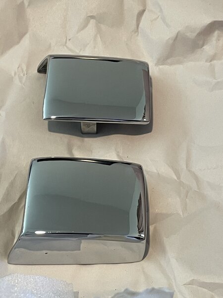

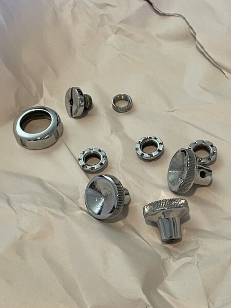

A little jewelery. Capital Metal in Tucson does it again. Wow. That bumper was mangled when they started. Only snag is waiting for the glass. Should be in a couple weeks.

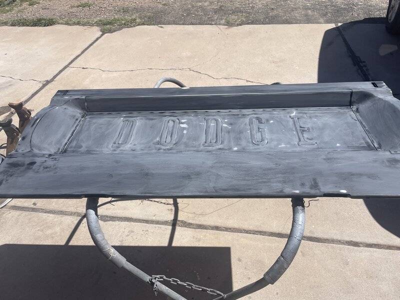

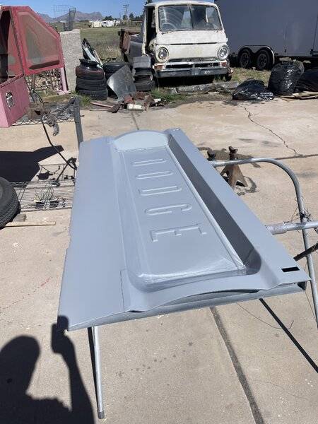

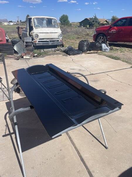

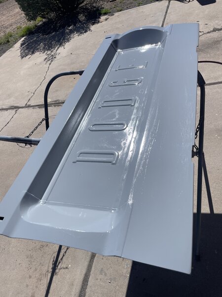

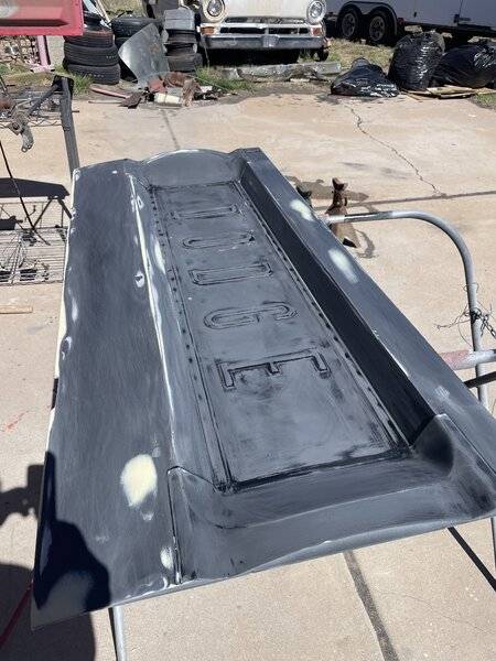

It’s never over till it’s over. Blocked out the epoxy primer that I put down yesterday found a few low spots and a few edges that I did not like. Little bit of glaze little more blocking with 80 grit and a quick sand with 180 grit and it’s flat. Sprayed on a couple light coats of gray epoxy primer and tomorrow a couple coats of 2K primer to fill in scratches and do the final perfect blocking. I so wanted to shortcut this tailgate, but just couldn’t do it.
