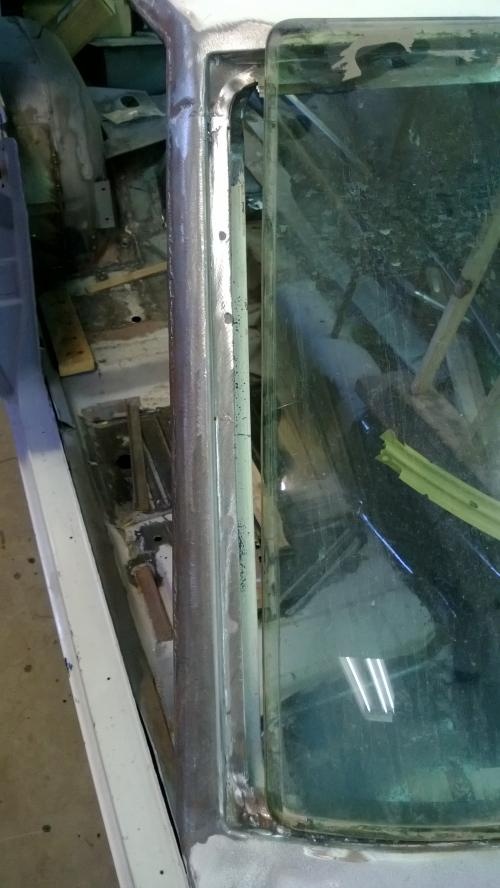

Here is windshield setting in opening. You can see how much smaller side to side the glass is than the size of the opening. I have the filler pieces for the sides. Just have to center the glass and get measurements for trimming.

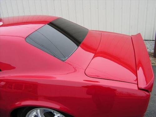

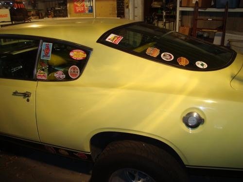

If it was me I'd put filler metal pieces on the sides and trim the top (or bottom) to fit without a rubber gasket. This way the windshield guy can apply his urethane around the opening and bond the glass directly to the body like all new cars. You won't be able to use your glass molding but it will look "CLEAN"....I know because I did my Barracuda that way. Also it will never leak!!
But you probably already have a plan, just thought I'd let you see what it looks like without the trim.

See the wide rubber strip you have, mine will be about 1/4" wide. I will have to modify my inside panels to fit the smaller window holes but almost all of it is sheet metal so it will be easy.
