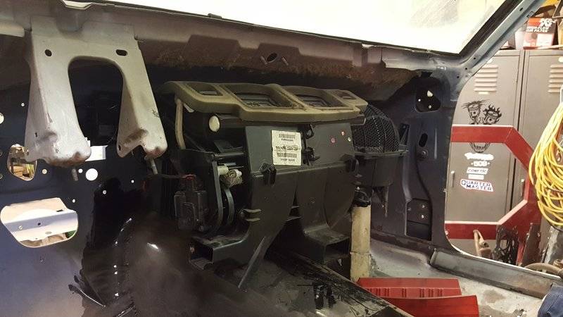

I did some work yesterday and today on the Cuda!! Figured I would try to fit the heat/a-c box from the 300 into the Cuda. Drilled some holes to mount the unit and discovered the holes for the factory wire bulkhead and brake booster needed to go. In the process of cutting and welding in sheet metal to flush out the rest of the fire wall.

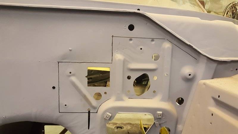

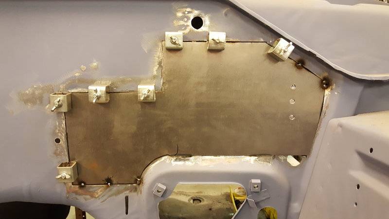

Got some pics of filling the firewall and modifying the 300 heater box.
Filling and welding patch panel.

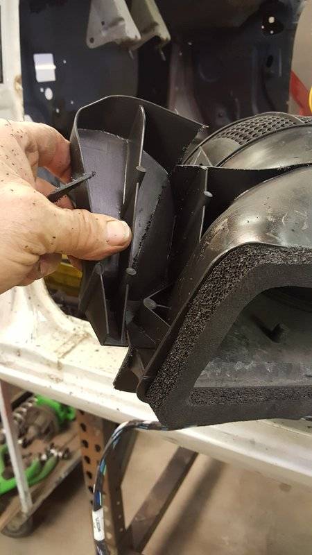

Had to modify the heater box because the firewall on the Cuda is flat compared to the 300. Plus, I wanted it to fit as close to the firewall as I could get it so it will clear the bottom of the dash. The 300's dash is way thicker than the Cuda's new dash.

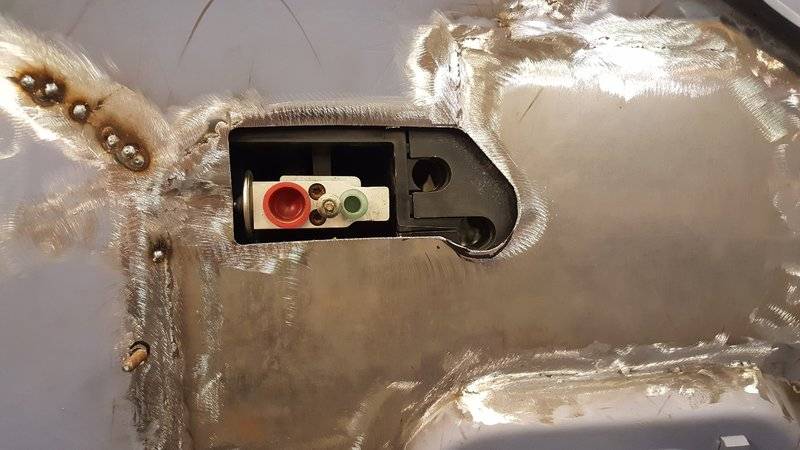

Made the hole for the a-c and heater tubes.
Had to clearance a little from my template. You can see where I made mark with sharpie. :)

Now I have to figure out how to get the adjustable pedals from a gen 3 viper to fit. The gas pedal from the 300 is fairly easy. Running out of room with that factory heater box! :)
