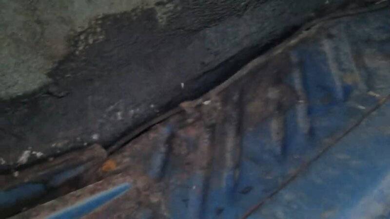

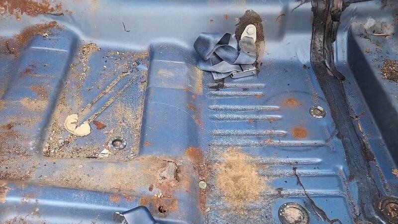

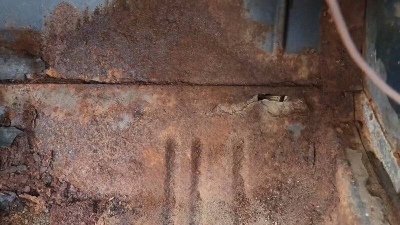

Got into the interior and got the carpets out so we could get a good look at the floor pans and see what repairs needed to be made. They were in better shape than I expected them to be. Now to find someone who actually has the sections I need in stock.

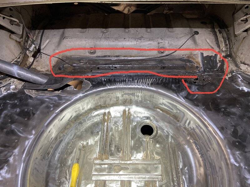

How’s your trunk look? That’s what I’m dealing with right now.
Looks Good. Small holes in the extensions but no rot in the trunk floor itself. Give me a bit to grab some stills from the walk around video I did.
Pay special attention to this recessed area here. It’s part of the “lower rear seat pan” the trunk attaches to and is only available as the whole $500 pan.
Once I took a wire wheel to mine I found it was Swiss cheese. It’s almost like Ma Mopar designed it to hold water on purpose!
I will definitely keep that in mind once I start prepping for repairs.
Also, took a good look at that spot. It is a bit thin on the ends but not rotted through anywhere yet. That may change when I get to taking the paint and rust off.
