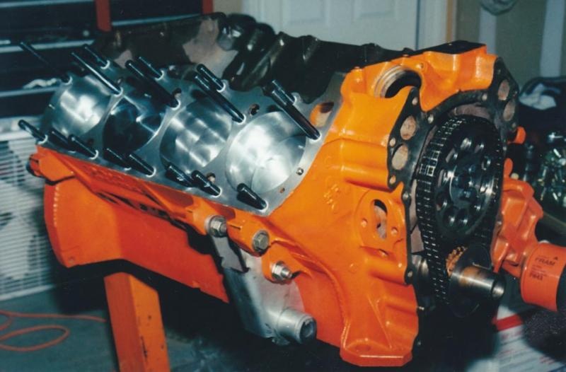

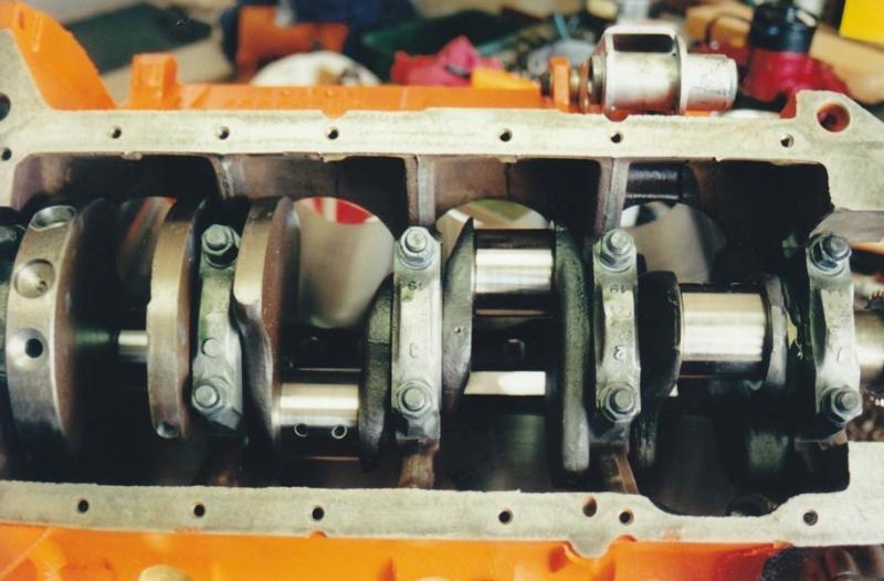

Here are some pictures from the engine build - in 2001...
