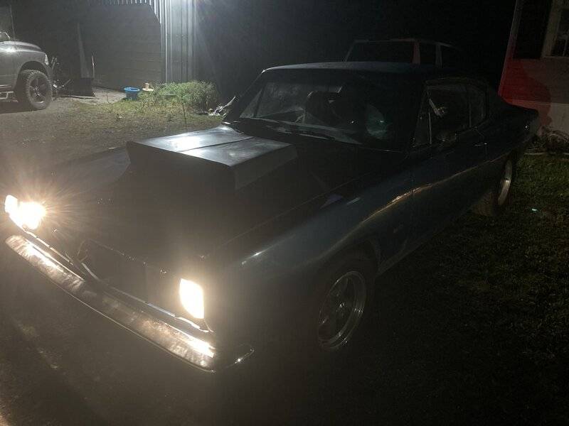

Also pulled the dash bezel out and hit it with some plastic, high bonding primer, and then some single stage matte black. It is still a little wet in the pic, but dried just as I wanted:
I did the same black treatment on the dash bezel on my 68 Barracuda.

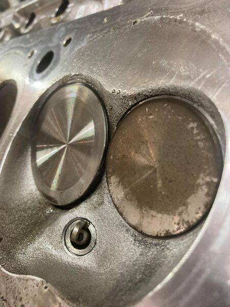

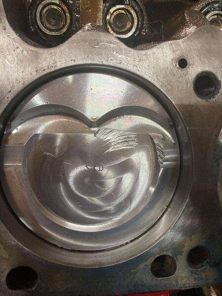

I did my initial start up with the Sniper EFI. It ran really well for about 10 seconds while the lifters pumped up. Then a valve lock came loose (my own fault). I shut it off pretty quick, but still made a mark on the piston and bent the valve. The piston is useable but had to pull the head and order another valve.
No big deal, just fix it and run it again.
