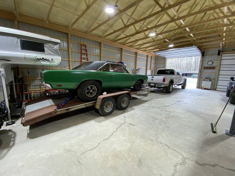

That picture back in the day on the trailer looks awsomCar is loaded up and ready for NC..............same car and same trailer 50+ years apart. My FIL also built the trailer.
