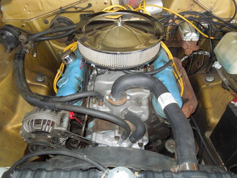

This is a totally stock, matching numbers 318 that came in my 70 Dart.
I added nothing but bolt on parts. Ede performer intake, ede 600 cfm, 340 hipo manifolds, dual exhaust/40 series flowmasters, Mopar Performance elec ign. Stock cam, stock 2.76 gear.
I acquired all these parts from old fashioned horse trading. The 340 manifolds being the majority of the cost. But in car terms, very inexpensive hp. This car was a kick in the *** to drive, easily burning rubber all the way down the street. One of my favorite motors, and setups. Anyways, you got the motor out, and you want to hop it up. Might as well go the distance and add a 4bbl. You will be happy you did.

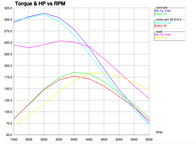

So I am going to back peddle since I never really looked at the cam without some of the other changes I have made. That is the same cam that is going in the Duster so I was interested..... Again this is a model but it is telling. The cam will make the biggest difference for low end torque outside of a stroker (did not include that data). All other items effect 3000 and up..
Next I looked at the difference between Stock/Stock with the Cam/My 318 build for the Duster. Notice in "cruise" RPM the extra $2500 I have in mine did almost nothing to where your stock with a cam is.
Then I added the 4 Barrel..... Unclear if it is worth the trouble if this is a cruiser but remember this is with a stock restrictive exhaust/small valves so the top end likely has more than these plots show if you let it breath better. The carb in itself would not be much help.
