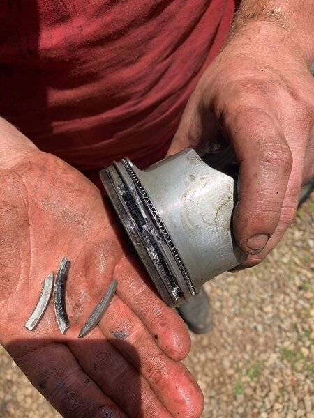

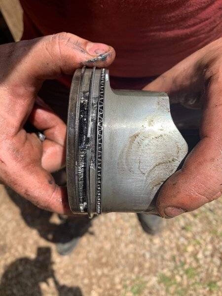

So I yanked the motor back out of the car and pulled it apart. The passenger side (good side) all looked as it should. The driver side however presented the issues. The odometer shows 15 miles including dyno time lol. New record for me.
Sooo back to the machine shop the motor goes. I already have the gen 4 rods and I'm going to figure out what pistons I'm going to use.
Holy Cow!! I have never seen a failure like that!! How could something like that happen?! to much boost? related or associated with the head gasket failure?!
Well whats weird is this was the opposite side of the blown head gasket. But idk, I've never done that before to pistons haha. I'm hearing from people that it seems that too much timing will heat the cylinder temps so much and even though the rings were gapped for boost they still butted and broke the ring lands. But I'm not sure.
Dropped the block off at the machine shop today. After Jerry (guy who runs the shop) looked at the pistons and bearings he said it was definitely detonation that killed it from too much timing. Just very odd it was only 1 bank. Hes never seen that before. I'm going to check my flex joint because I've been reading some nightmares about those collapsing. He said the block really should be bored over at this point but then we'll have to pull the cam bearings and basically start over so I'll have a $1500 bill again. Not worth it for a 5.3 when I have a 6.0 up in Vermont I'm going to build this winter. So I ordered some stock 4.8 gen 4 flat top pistons, gave him my gen 4 rods I had ordered and we're just going to slap this block back together sloppy style with some honing and send it until I build the 6.0. He said this will work fine but it may need rings again by 50 or 60k miles because of how much we'll have honed the cylinders. But I'll never put that many miles on this motor since it's going to go into my CJ when the 6.0 goes in this.

Dang I’ve missed so much. I’m not getting the updates and I’m following this thread. Stick with it. You’re having the same teething issues anyone has with turbo builds. And it’s exactly why most people don’t finish them. You’ve done well to continually move forward and hopefully you’ve learned from every failure. It’s all worth it in the end when the boost gauge goes to 20 and the dyno needle moves past 800. You’ll get there. And I’m putting money down on the sloppy rebuild making the power. They usually do. Gap them rings WIDE I can’t say it enough.
Broken rings and broken ring lands are fairly common on forced induction builds unfortunately. It is from too much heat in the rings. And not enough gap. It can be caused by a variety of things; detonation, overboost, timing, octane level, just to name a few. Tuning is very important and the window is small especially for pump gas. It takes a thousand parts working in perfect harmony to get it right, and one small part to fail for it to be catastrophic. It’s all part of the fun.

The hyper pistons in an LS are tough but brittle as glass. If you stick a ring they will break. You've already seen this. I like to know for sure that I’ll never butt the top ring. So I go larger than most people are comfortable with and am willing to give up what little cylinder pressure (if any) I give up to get that reassurance. And I go a little larger on the second to keep from loading the bottom of the top ring and loosing ring seal, knowing my crankcase evac system can deal with it. It’s not rocket science but it is worth doing. The difference in cylinder pressure between 024 gap and 030 gap is negligible and probably not measurable and I know a ring ain’t gonna butt at 030 but I don’t know that at 024. Some guys disagree and I’m ok with that but I snapped a ring land on an expensive big block Chevy and I payed the bill, and won’t do it again.
A couple more updates. Got the new 4.8 pistons to the machine shop yesterday with the gen 4 rods. Also we looked at his piston chart he has from Mahle that says to gap the rings .005 per inch. Thats what he had done which puts me at around .019. I told him that wasnt enough for the boost and beating I'm running. So I told him at LEAST .008 per inch. Basically telling him .030 to .032 for the ring gap. So they should have the bottom end all back together next week with the new bearings and the rings gapped. I've put enough motors together now I have no shame having a machine doing the bottom end on a motor thats getting the **** beat out of it since they have all the correct measuring tools. Where as I have a micrometer, calipers, mag base with a dial indicator and a hammer.... thats about it for precision measuring tools. Hopefully I'll have better luck this go around!
