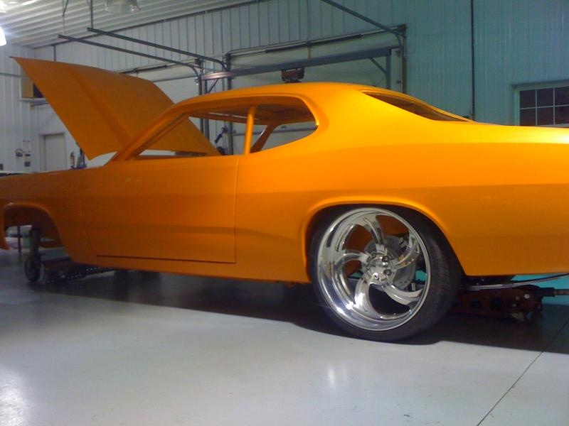

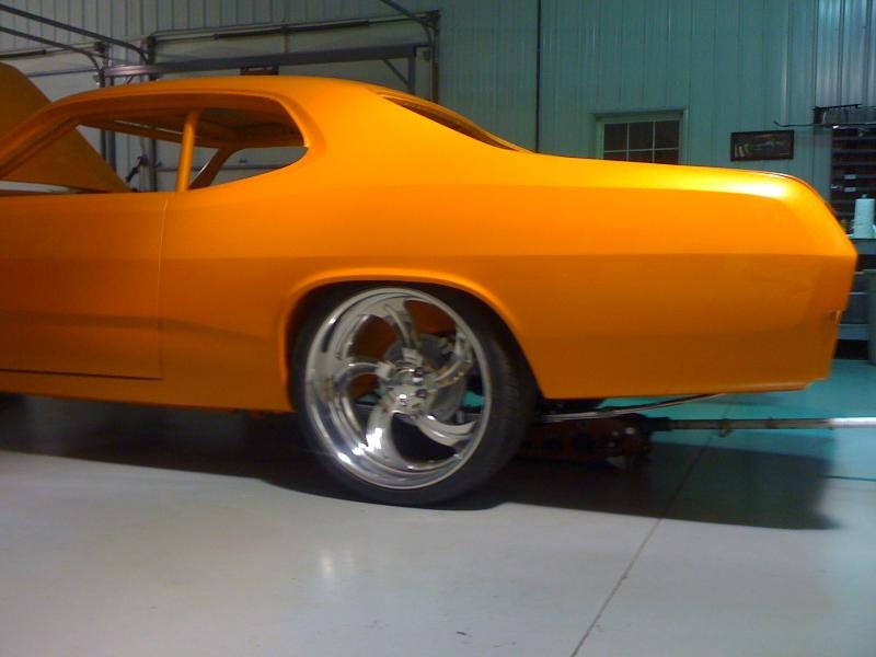

here are some meats 22x10 with 28.7"tires by the way the cup holders are also chrome lol
and some pics of the front end going together

very beautiful car, I would go with more rubber (sidewall) but not the centerlines as suggested, 18's would be my choice but it is not and your car wears the 20's nicely.

Those are way better than the first choice of rims and tires.... looks good! Jesus! did the guy have his sack chromed also! lol
Hey Bob....... I have to agree, those big wheels look real good on that car, Brandon agrees too..lol......... After all Its going to be a work of art when its finished, not a everyday driver and race tracker.

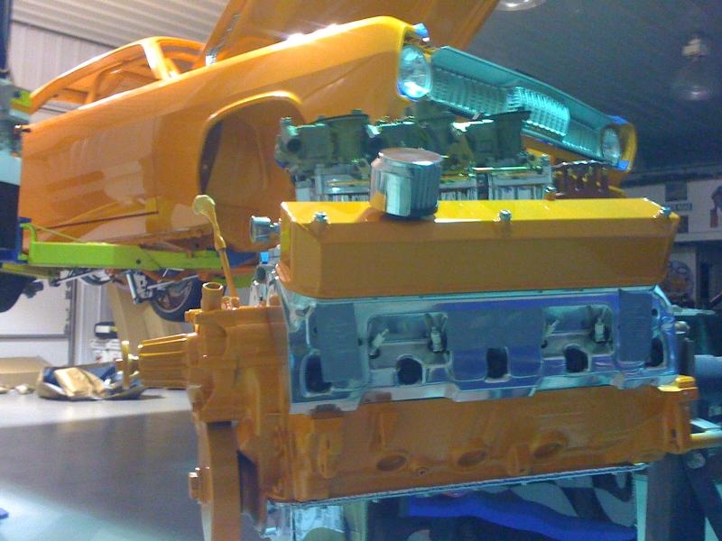

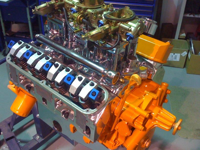

well here are a few pics got the motor together mostly and everything prepped to put together and mate to the car all looks great just sitting there should have it in the car tommorow

wow looks great! I love it, and it looks like you keep your shop real clean to!
Actually its in my friends shop Paul Jacobs of Jacobs restorations he was kind enough to let me use it and his lift to get the motor and front end work done then back to my house. He does some of the best restorations in the country with many awards to back it up. oe gold like six or seven years in a row at the nats among others.yes he keeps it very clean
what's wrong man ??? I cant believe theres not a single chrome bolt on the torqueflight .....Seriously though, that car is truly a work of art. This build reminds me of one of all chromed out World of wheel show cars...simply incredible..great job

Your K member, and tranny-is that base clear or powder coat? If its base clear, what did you add to the paint to help keep it from heating up and discoloring?

i used base coat clear coat i used house of color tangelo pearl orange which is a tri coat color . White base, pearl orange then clear first of all house of colors paint are some of the best colors out there but there product is such a pain to use the first time we used thier white base then the orange it wrinkled up every where so we adjusted everything and it did the same and these are supposed to work together finally we just used bright white epoxy primer the the color and it worked perfectly so then the question i would not use thier clear so we used spies and hecker high solids high performance clear also high dollar they all but guaranteed it wont discolor with heat

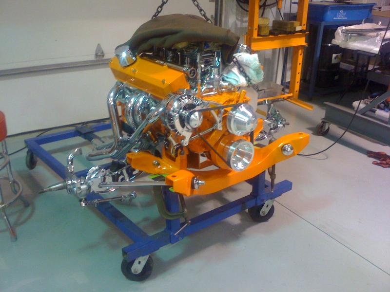

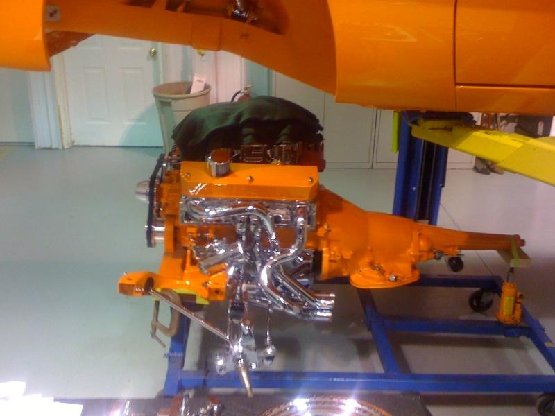

well worked all night the front end and motor is in its new home now i have to button it up:hello1:

I have a lot of questions...but then I remember your previous builds and realize you got it figured out already...so I've learned to "just stay tuned"
from all of us out here....thanks for the continuing pics and posts

Denny nothing with car building is ever cut and dry something will always go wrong no matter how much you prepare and mock up changes will be made lucky for me whatever i do not know i have a book and one of the best car builders in the country to ask questions im shure you ran into alot of trial and error shoehorning a 426 hemi into a body duster like the header situation my headers just barely miss the inner fender well i could imagine what you went through. thanks i like posting pics and progress reports it gives inspiration to people like me in the winter when i all i want to do is be warm lazy and watch tv all night amazingly this project was started 20 years ago im just finishing it the way the previously owner should have his problem was his wife would only let him spend about 2,000 to 5,000 a year and that was it then he finally got rid of her and the new one made him sell it.

wow that is sexy i love the clean look of the shaved firewall i plan on doing the same.
