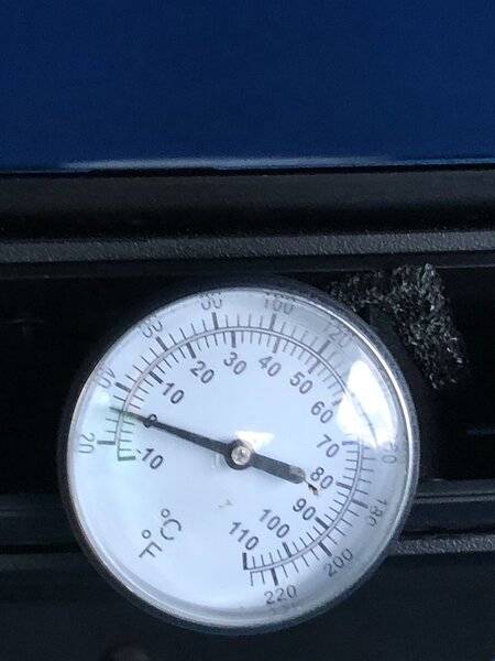

FINALLY the Daughters Duster will freeze your nipples off. I will try to limit my rant of aftermarket parts. The POS aftermarket expansion valves flood the evaporator and I went through 3 compressors where the super heat was totallly wrong on the valve and flooded liquid into the compressor failing the reed valves. Bought NOS reed valve plates and a NOS expansion valve (yes it is R12 BUT THAT DOES NOT MATTER). I plan to tighten the spring in the valve on turn in to compensate for the R134A with this valve but all the problems are gone and it is flipping cold 32F on the road on a 75F afternoon.
FINALLY the Daughters Duster will freeze your nipples off. I will try to limit my rant of aftermarket parts. The POS aftermarket expansion valves flood the evaporator and I went through 3 compressors where the sub cool was totallly wrong on the valve and flooded liquid into the compressor failing the reed valves. Bought NOS reed valve plates and a NOS expansion valve (yes it is R12 BUT THAT DOES NOT MATTER). I plan to tighten the spring in the valve on turn in to compensate for the R134A with this valve but all the problems are gone and it is flipping cold 32F on the road on a 75F afternoon.
View attachment 1715723998 View attachment 1715723999
32 degrees, nice!

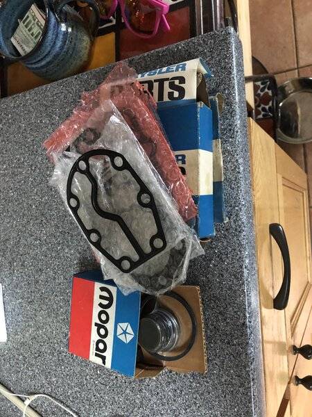

I just got the OEM numbers from the parts book and put in eBay searches. If you don’t find anything save it so it notifies you when something come available
This is great information. Is there anyone out there who rebuilds and repackages OEM air conditioning equipment commercially?
My original under dash stuff was cleaned and freshened when I did the rebuild on the car 6 years ago, but I have not decided what to do with proceeding under the hood with the AC. It’s the last thing left to do.....
I still have all the AC stuff for you.
