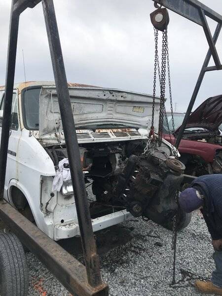

3 1/2 hours by yourself? You were hustling. Good thing it wasn’t summer. And that doesn’t include drive time to and from.

3 1/2 hours by yourself? You were hustling. Nice work!!! Good thing it wasn’t summer. And that doesn’t include drive time to and from.

It was sunny but not sunburned weather. we've had pretty good weather lately.
From past experience I knew if I was going to be in the sun I needed to do it first thing and then get into the shade for the majority of the work instead of Vice Versa getting sweaty and oily and greasy then going out to the outside sun is like my least favorite thing. I brought an old beach towel and some gloves and was totally spotless until the typical junkyard thing happens when you pull a radiator in the bottom hose still attached flips back and launches the rusty as **** water all over your shirt LOL

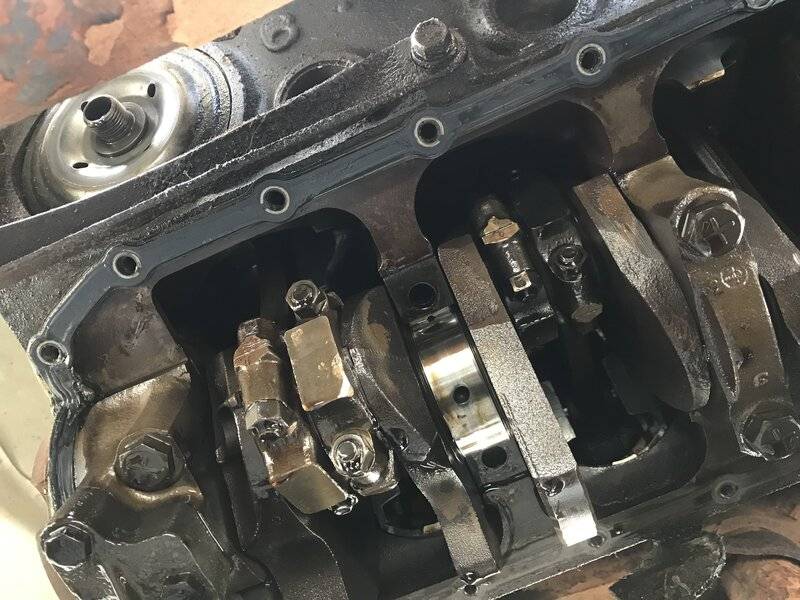

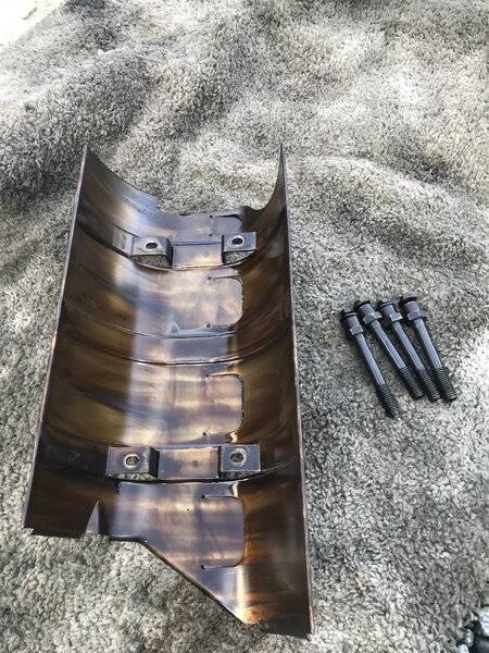

Well I came and pulled the pan on the 360 at the yard. It’s a non roller engine, but it had a windage tray. Build date for the van was Oct ‘90. Little confused.
There is a Z in the vin. If that’s what your asking?
I took the distributor out and I can clearly see a flat tappet lifter.
Some of them came with flat tappet lifters even though they were a roller block so the key is.... is it a roller block or not, yes of course... and if you look at the actual valley.. you'll see the bolt holes to mount the roller spider ....and that's what's important and what you need to see. you scored bro, right on!

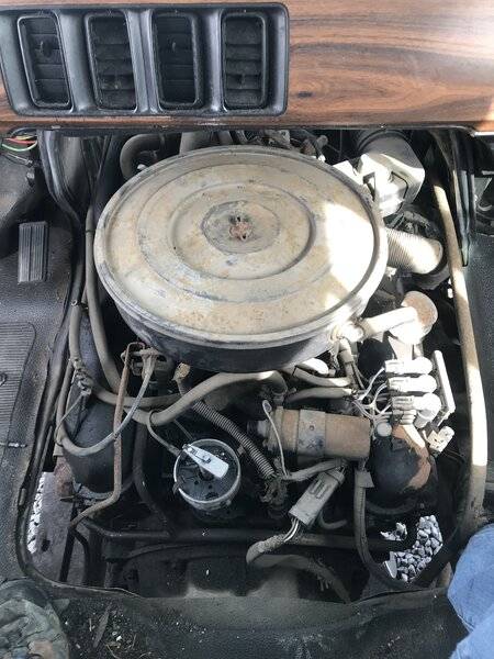

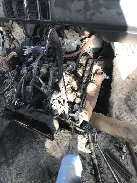

Well. I was sittin on the pot and decided to check inventory at the local Pick-N-Pull again just to see what they had. They listed a ‘91 ram van with a 360. I had to go and check it out. Odometer read 90,479 miles. Ended up pullin it out, after I removed the distributor and looked inside I saw roller lifters. $234 Out the door.
I just pulled a ‘92 LA 360 out of a Ramcharger this weekend. I’ll have to check when I get it up on the stand and see if it has a windage tray also. That would be rather nice.
They didn’t have a 308 casting but it did say 587? I think?
So as we keep learning here.. is it that if it doesn't have a roller cam in it 'even though it has the provisions' ..that it won't have the 308 or big push rod hole heads and can have any of the later standard LA heads instead. Good to know.
View attachment 1715678300 View attachment 1715678297 View attachment 1715678296 Well. I was sittin on the pot and decided to check inventory at the local Pick-N-Pull again just to see what they had. They listed a ‘91 ram van with a 360. I had to go and check it out. Odometer read 90,479 miles. Ended up pullin it out, after I removed the distributor and looked inside I saw roller lifters. $234 Out the door.

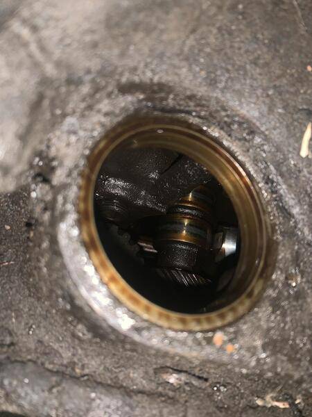

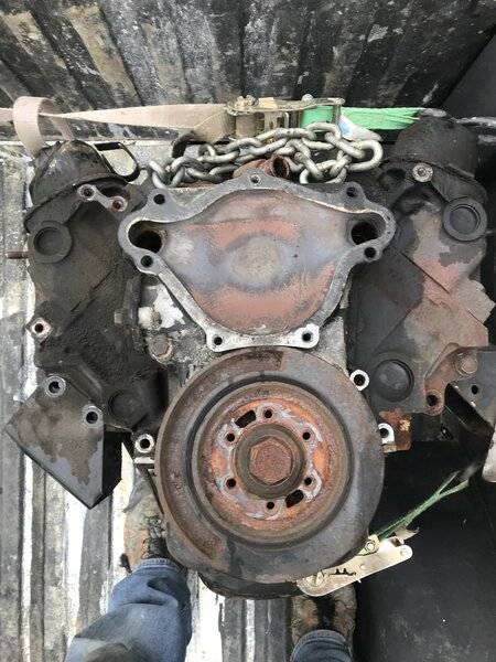

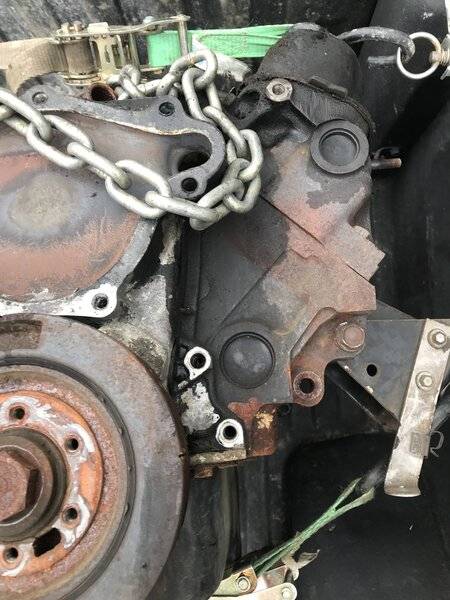

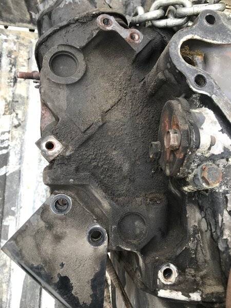

What I found interesting about the ‘92 motor I pulled was that it did not have the timing cover machined for a fuel pump. Others I have seen are machined and have a blockoff plate, like the one mopardude posted. Here’s mine:
This one also has the roller gear inside:
I assume it still has a long snout cam, but the timing cover kind of makes me wonder.
Although the motor came out of a ‘92, it has the earlier 89-91 casting number: 53006921. Probably an early model year production ‘92.
The camshaft wear on the one I pulled looks identical to your picture. I wonder if I clean up the engine a little, and put all new gaskets, flush out the block and install new freeze plugs, maybe I can run it for a little while.
