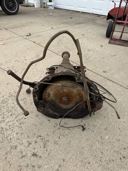

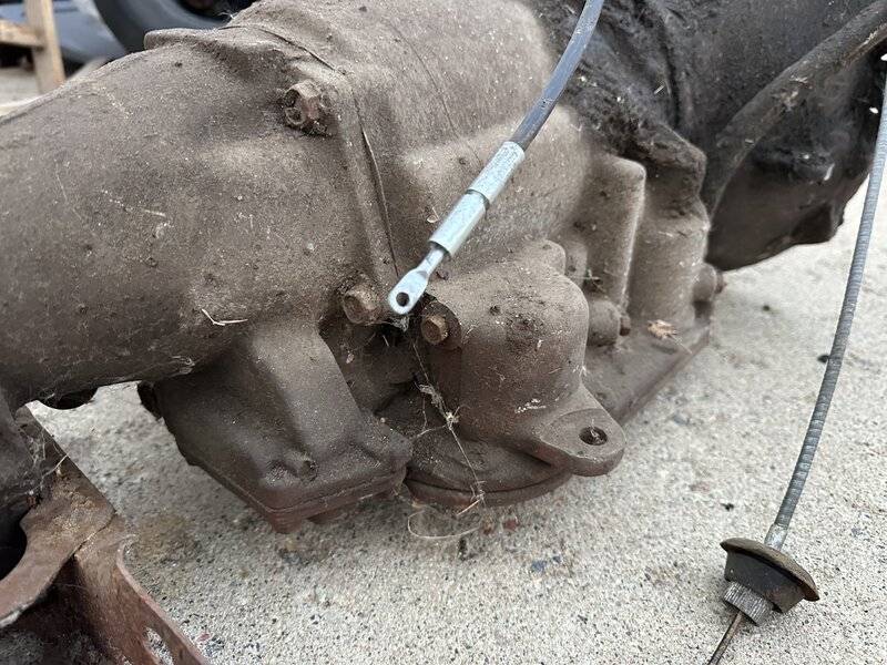

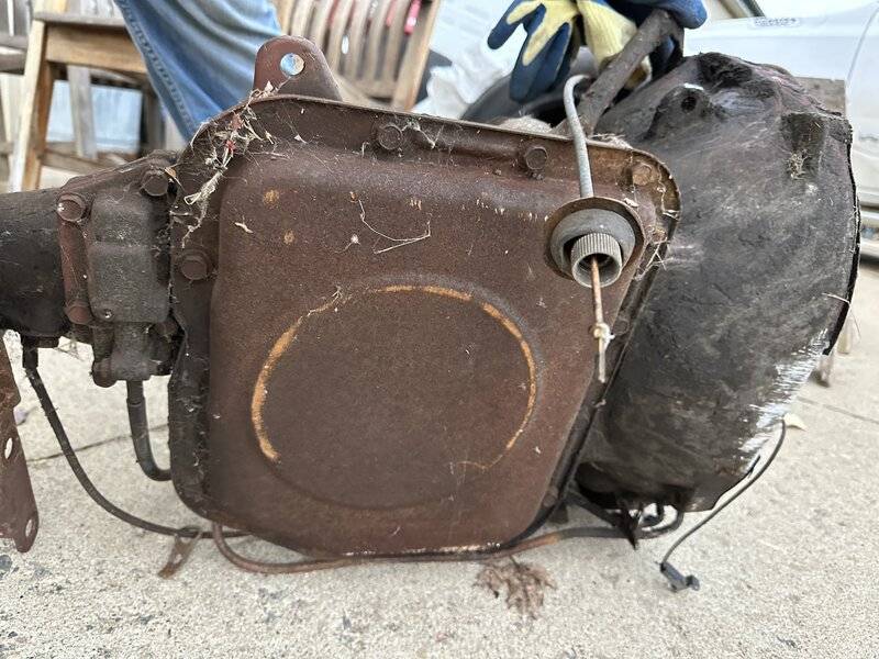

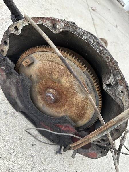

I have this 904 273 Transmission, not sure if it’s a 1964 or 1965, is there anyway to tell from my pictures which year I have? I believe 1964 and 1965 are different…I just don’t know much about these years, thanks!
Clean off the aluminum case on the driver side just above the oil pan. There are numbers etched there they look like this:
Once you know the numbers they can be looked up in various books that will tell you the answer. Many folks on here, including me, can help you with looking that up.
Here are some numbers on the left side just above the pan. :thumbsup:
