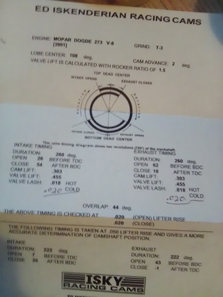

The Wallace calculator predicts, with cam of 260/260/106, in at 104, with a true Ica of 54*, points to 150psi at ~8.85Scr.
But, because it's a solid lifter, I have no idea when the intake actually closes.
Probably a couple of degrees earlier
At 52*, 150psi would be ~8.75Scr.
So; if your Scr was a true 10:1, and
the intake actually closed at 52*,
then the Pressure could be as high as ~179psi;
Or if the Leakdown was 16%, then yur back to 150psi. But if your LD was that bad, she'd likely be a bit of an oil-burner, leading to detonation.

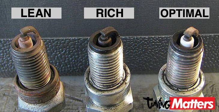

plugs all looked fine a nice light tan brown color champion n9y .035. the timing mark on the spark plug strap was near the base ring not an the curve point on the strap. timing set at 16 initial 18 in the plate and 34 total.
At what rpm is the timing in. There should not be brown on the plug. That’s fat.
Edit: At your compression a 9 is too cold.

another thing isky told me was this t3 cam was good from 2000 to 6400 peak power. the engine seemed really happy around 5800 and was still climbing .. I never took it above 5800.
from what you are telling me this t3 cam was all done pulling under 4800 is not even close . I can assure you of that lol

Yeah, that’s fat. Light tan is fat.
click on pic to see all three type conditions.. mine never ever looked like the middle pic or the one on the right pic . all mine looked like the lean pic by reference . this pic is not my plugs just a reference .

If your engine is pulling past 5100, with a 222/108 cam, that only means one of maybe three things;
1) the cam you installed does not match the camcard you posted, or
2) the cam has flat-lined early, due to environmental complications, or
3) you haven't actually driven it fast enough to feel it nose-over, cuz until you do, there is not enough time to actually feel it.
The camcard you posted says 44* of overlap. With headers, that should put a nice lil power bulge on the power curve. With headers but a less than stellar exhaust system, or without headers at all; that would mean a long flat power curve/without a powerbulge, like a 340... So yeah, I get it, that you might think it's still pulling at 5800.
I assure you, that I have had bigger cams in much more potent SBM engines than your 273. I even had a cam similar to the one that you posted the camcard for, and while it was a nice hi-torque cam(223/230/110/51overlap), it peaked at around 5000.
Oh sure that lil cam pulled to 7200 as well, but it was way past pulling hard. I just went there cuz she sounded awesome, screaming thru dual 3" cannons, and she was happy about it. The thing is, until it hit mid-Third gear, there was no way to feel the nose-over, cuz at WOT, the tires were still spinning.
I'm glad you like your 222/222/108 cam but 050-wise, let's face it; it's just not that big.

If you shift late, you should come in at a higher power, but leave at a lower power. I like this a lil better, cuz this gives the car a lil kick-in-the-azz; but your engine has to survive the extra top-end rpm.
Now, if you have an automatic, that's a whole nuther thing.
So
Get yourself a windshield-mounted accelerometer and it will reveal the truth to you.
I under stand ......
why would isky tell me the peak power was at 2000- 6400 ?
I always had the rev limiter at 5900 and bounced off a few times and it felt strong and could not feel a dead spot nose over yet
if that cam was suppose to be all done under 4800 why would it still feel strong and still pull to 5800
If this isky t3 cam is that small I think I will not used it again in this new engine build . I'm going back to the big erson cam I had in previously.
