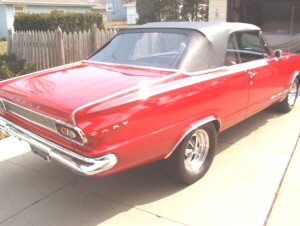

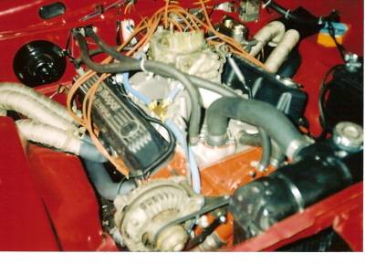

great to here 273 lover....I have been waiting for someone to ask that question .... the answer is because I like to be the underdog and I proved it with a few of my buddies built 340 360 and 380 horse magnum engines in dart duster and barracuda . you just have to spin the engine a little higher and they will rev LOL. they still think it's not a 273 engine. I love the small block engine !
This built 273 in my 65 barracuda is the fastest small block i ever owned and I had dozens of sb mopars and nothing compairs to this built 273 except for a magnum crate 402 stroker I had in that 65 dart rag. that car was a 11:50 car all day on motor.

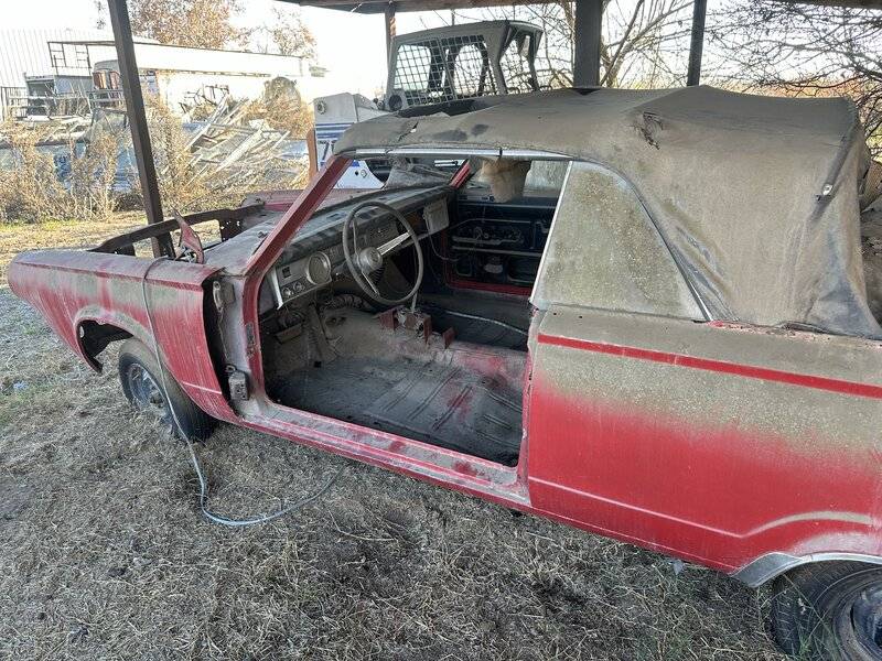

this was my car also it's a rare 65 dart charger 273 commando with cam and d4b intake/ headers. don't know anything about the cam but that engine would rev to the moon.. previous owner use to race it. here is a video .. It's tired as you can see and real loose. those revs were over 6k one 6500 rpms. this video is right after I installed new valve seals.. did not help much..
