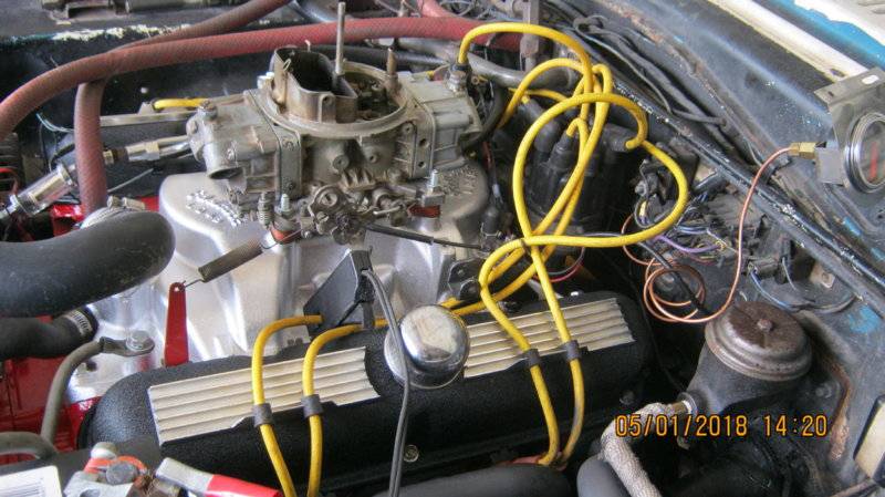

The 273 commando is up and running . it fired right up , no issues , sounds awesome ! I'll post a video soon.
been working on these videos now for about an hour . I"ll try it again another time. so Frustrated.
another couple hours trying to load these videos . I give up. I'm not getting anywhere posting them on you tube or photo bucket. I have better things to do like cleaning up my garage and the barracuda after this ordeal.
here is a pic at least for you guys .
I have approx 60 miles on the commando now and it has more torque and hp than last engine . Haven't taken it over 4500 rpms yet , but it really feels strong . Revs real fast , has a totally different sound than last engine also. Compression "Does" make a difference !
