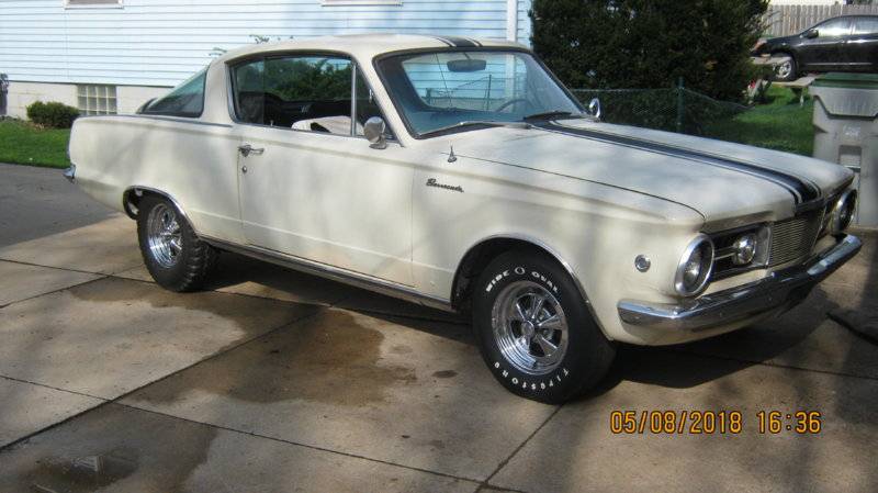

I have approx 60 miles on the commando now and it has more torque and hp than last engine . Haven't taken it over 4500 rpms yet , but it really feels strong . Revs real fast , has a totally different sound than last engine also. Compression "Does" make a difference !

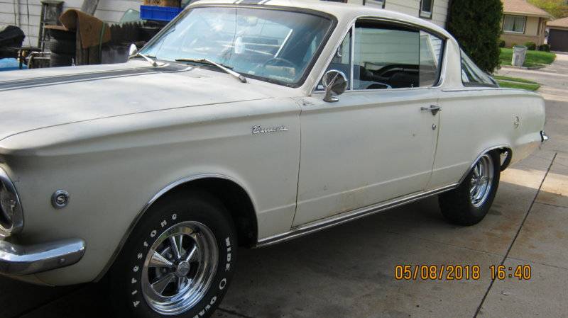

That sounds healthy, great job. I see fenderwell headers, are you running duels out the back? I only could see one tip. The sound is great. Do you have any video of it at low idle? How does it lope? With the power and torque, I think I'd like to copy your build. If you don't mind. :)

I run 2.5" head pipes off headers thru 2.5 flow master 40's , nothing over the axles yet with 2.5" . the tail pipes on there now were just cut off after old mufflers before they go over the axles. just fakers for now. Right now these fm 40's are soooooooooooooo loud inside the car but it sounds sooooo good ! I'm afraid I'll get pulled over for loud exhaust at some point. I don't want rappy exhaust sound if I put tail pipes on. more videos coming soon.

"Brewers performance" has all components for 9.5"' and up clutch parts. they have a website . I am running the oem 9.5" clutch in my 65 barracuda with no issues . Does not slip at all .
