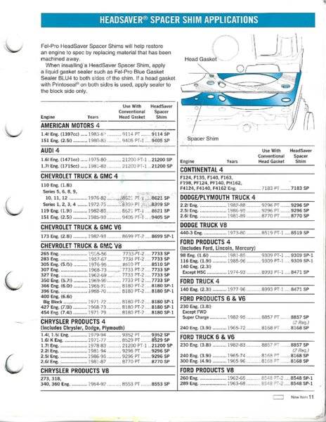

Here's those Fel Pro pages on head gaskets from a 1997 catalog.
