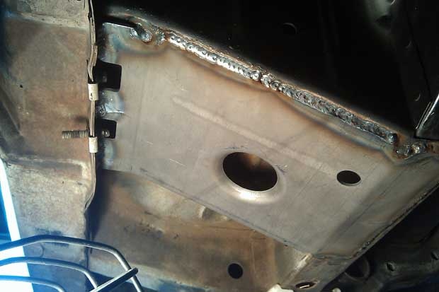

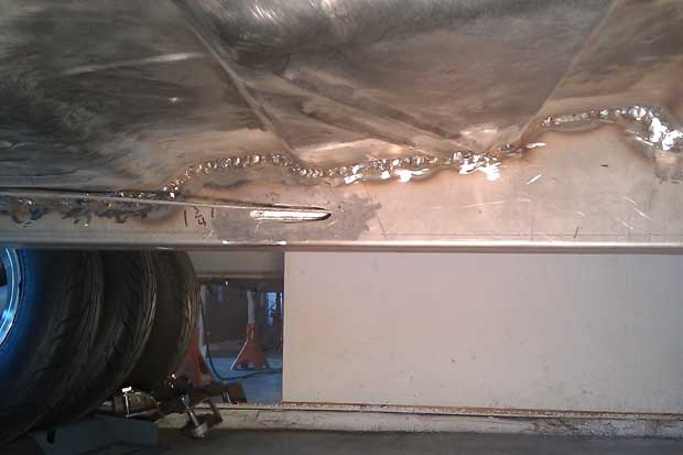

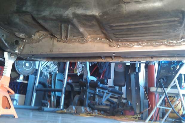

I got a little more progress done this weekend. Subframe connectors fully welded in and front torque boxes added.
Unfortunately the rear end was sent the wrong width. I am taking it to a local shop to get shortened and new axles will be sent. Bummer.

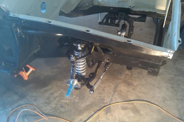

A little more progress this last week. Got the rear torque boxes in. Installed most of the front suspension. Waiting on brakes for all four corners to arrive. I'm taking the rear end housing tomorrow to a shop to get shortened to the right length. Slow and steady.

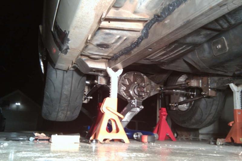

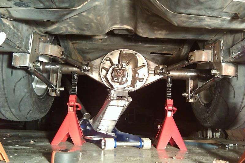

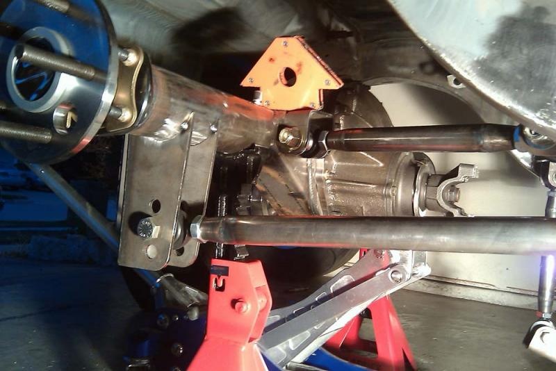

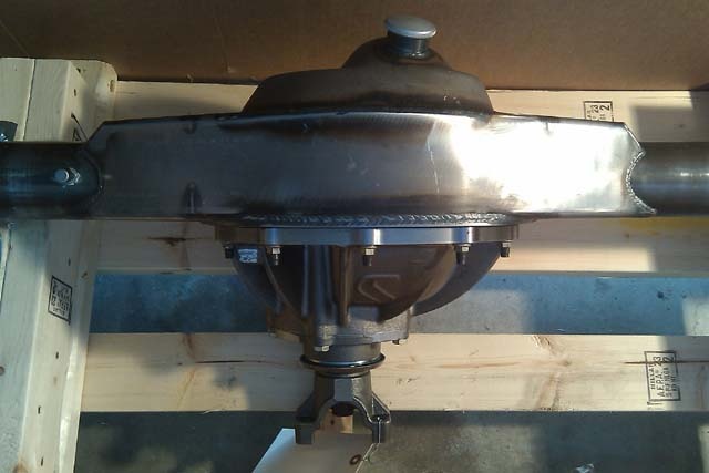

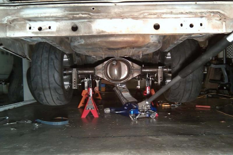

A little more progress this past weekend. Started installing my first four link. It was pretty intimidating. Measure, measure, measure...spot weld, measure, cuss, cut off spot welds, measure...third time was the charm. As far as I can tell, measuring it from about six different ways, its centered and square. I need to put the coil overs in this week. Then disassemble and finish weld. Then I will start hunting for a powder coater. The brakes should also be here this week. She will be sitting on the ground very soon.
The first photo is the only real modification i had to make to the Control Freak kit. The bracket is made to sit on the flat and radius of the housing. This housing's bracing came out further so i just cut the radius off.
The last photo gets me excited.
