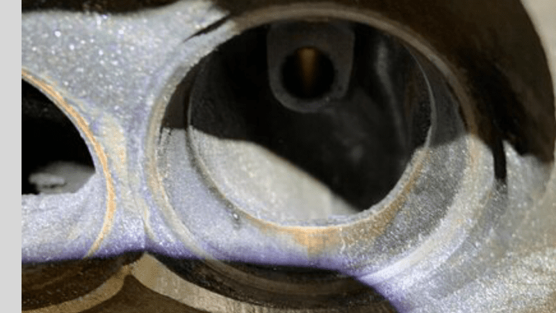

I wish I had gotten better pics. I opened them up a good amount. Not sure about % though. They were kind of oblong and I tried my best to make them circular below the seat. On that short side you’re right there was a sharp edge I really had to smooth out. The more time I spent in there the more I understood some of the stuff you guys have been saying. I got them to where I was comfortable with and just asked the machinist to look them over and make sure nothings glaring to him. Your videos and mopar joes were very helpful. Few others that escape me.

This isn’t a comment on the porting efforts, but more of an observation about what you were starting with.
With no bowl blending or deshrouding in the chamber of any kind, I’d say the install of the 1.88 intake valve could easily have been a step backwards.
I agree. I wish I had been able to shave the chamber side down before the bigger valves were put in but I got them used. And the valves are now so close it was very difficult to do anything without touching the seat. So I ended up focusing on the bowls. That pic is what little I did on the chamber side but before touching the bowls.

Car fired up and running. Lightly ported my intake. Didn’t go as far on the heads as others but did significant work and 3 angle valve job, plus having 1.88/1.60s in them. Headers. Car is an entirely different animal. Runs good and I’m pleased. Thanks for the input everyone.
