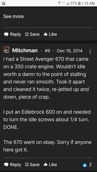

Best to just swap a carb on and see if it runs. A regular old 600 Holley would do....
I wish I had one. He'd have it already. I have this Eddy 750 that I cannot get to run right no matter what I do to it, or I'd send him that.
