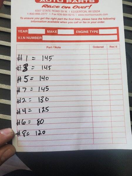

I pulled two plugs tonight to do a compression test. Both plugs looked extremely clean. Light brown I'd say. I got tired at the end of the night but number 1 and 2 are at 145 psi. I will do the rest this weekend.

I always pull all the plugs when doing a compression test. Maybe I missed it, but did you cap off the distributer vac line while looking for a leak. I hidden leak can be in the distributer diaphragm, same as in a brake booster.

The brake booster vac line does not go the carb but to the intake. There are other vac lines that go to the ac switch, if you have ac. I use WD40 to look for leaks around the carb base, intake to heads and other vac locations. Be careful using a highly flammable product for that purpose. Being one bank is all low on compression, I think you may have a head or valve issue not a head gasket issue.
