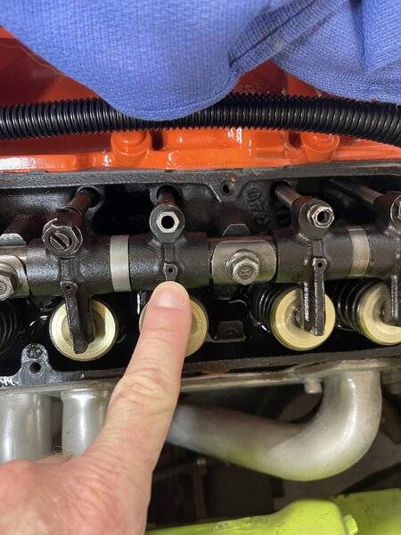

Guy’s need your help. Again I am new to C-SBM oiling.
My wife and I worked on priming the oil manually. We held a constant 60psi while I slowly rotated the motor.
I never saw much more than drips out of the bottoms of the rockers.
I expected at one point to see it come through the small holes (see pic) on the rocker arms but those remained dry on both sides.
I rotated the crank 4 times through the complete valve sequence.
What are your thoughts?

Joe this is exactly what I have been doing. We did 3 sessions of this without seeing any oil flow out through the rocker arm holes. I ASSUME I should see some at two points of the cam/crank rotation.
Maybe take rocker shafts off and chk for flow there 1st? I know it took "a bit" to find her sweet spot.

Maybe but @60 psi and rotating by hand every 40 degrees and stoping and doing it again …… wouldn’t that be much much longer in duration (aligned and open to flow) than running the motor at 2000 rpm? At that speed and higher the engine needs lubrication. Should oil spit out those holes even if I roll by hand past those points?
have the rocker arms been off the heads at some point recently? they need to be orientated in a specific way on assembly so that the oil feed holes in the shafts align with the ones in the head.
