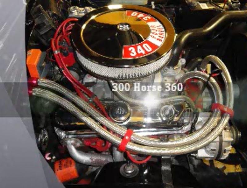

This is a photo of the motor. Its not a magnum 360, can someone help identify? Note the oil filter.

Maddart, that oil filter adapter could have been added on at any point. It could be that guy had it on hand and just said screw it I'll use it and/or he needed it with those headers due to clearance issues. IDK exactly, but it is a pricey part these days.
Also, the pre Magnum create engines are something I can not I.D. The engine in car makes it to hard for a good I.D. The pre Magnum create engines (AKA Commando) came in 2 flavours. 300 and 360 HP. The 360 hp engine came with IIRC, 308 - 2.02 heads and a MP 284/.484 cam.
I'm sorry because I can not be off more help.
Well your motor is DEFINITLY not a magnum motor, that's an LA small block....360 or 318? I don't know crawl underneath!:)

Look directly at the front driver side of the engine IMMEDIATELY under the parting line between the head and block. There should be a long stamped number under there, and the first few numbers should have 318, 340, 360, etc right in that number, UNLESS it's some factory re-man, some are "xxxx" 'd out. (I have a "Mopar" branded reman 360 that's this way. It had a "Mopar" id sticker epoxied to the block)
Then you'll have to get underneath and look for the casting number on the side of the block.
What you have there could be anything from a 273 to a 360
