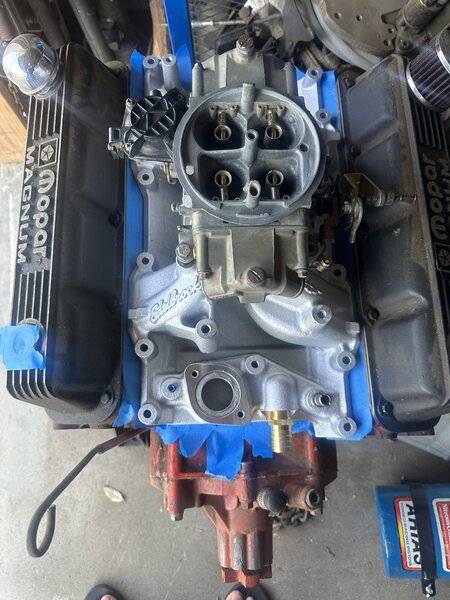

With the aluminum heads and our elevation, I doubt we'll hit 11:1. I really didn't want that much but got talked into it. We had 11:1 in my wife's '73 Cuda and ran 91 octane. That 360 ran pretty hard.
