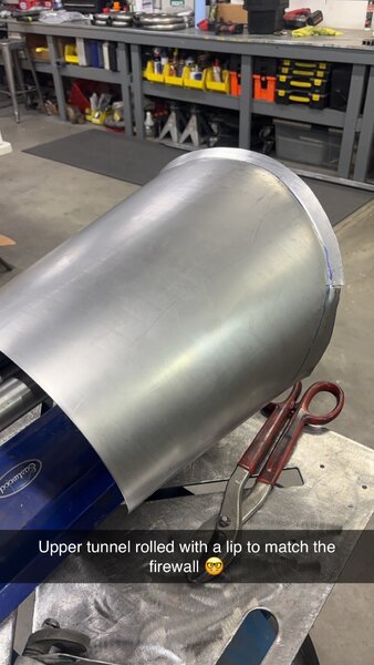

Transmission tunnel is done. Onto headers and exhaust.

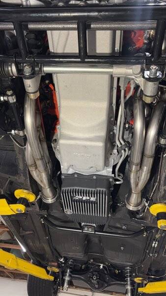

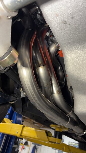

Headers need to be finish welded but they are all mocked up and looking great! I’ll be heading to drop off some more parts and check out the progress in person on Sunday!

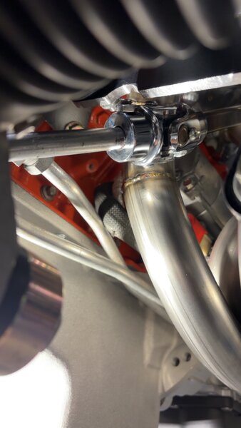

Wow, how will you remove the Headers when neccassary? Remove the whole Steering? have to remove that intermediate shaft, it’s got universal joints. Not too bad.
Gonna have to remove that intermediate shaft, it’s got universal joints on both ends. It’s not too bad.
The headers look awesome. What size tube and collector did you use? Want to make another set?? Lol that's what's keeping me from installing a gen3 hemi in my 65 valant. I am not a fab guy and nobody makes off the shelf headers for my car. I just bought a 21 ScatPack challenger and for as big a car as it is. The car runs damn good. The 6.4 hemi ought to be a blast in the lighter valant.
Thank you! I can’t take any credit for them though, I have a friend of mine helping with a lot of the fab work on this build. They are Smith Innovations stainless header flanges in 1 7/8 to a 3” collector. These are probably pretty specific to this car cause the steering and motor mounts are all custom. I would do some networking to find a fabricator near you to have them built. My buddy builds a lot of different parts and he said “Damn them suckers were difficult!“. I appreciate it, I’m hoping it all works together well and runs great! Out of curiosity, what’s your scat pack weight? What is that car rated in the 1/4 mile?
