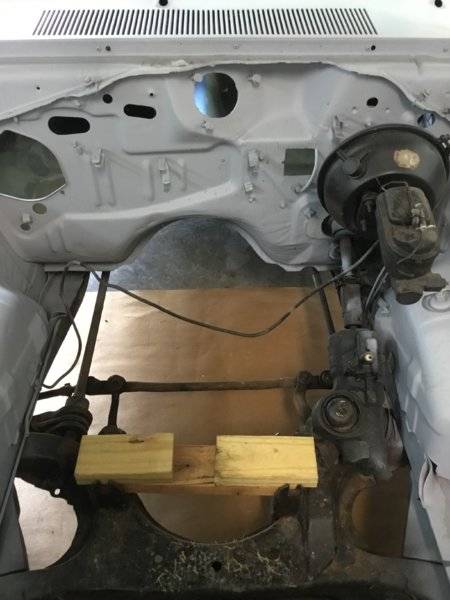

Did you drop the body down over the engine and suspension? Someone told me the hemi was too big to do that, and I had been planning on doing it that way.
I dont think the 6.4 will let you drop the body down over it without firewall work. The 6.1 has more clearance in the back. It's a little tricky with the alternator by the frame rail but you can just lower the car over the engine once you clearance your firewall.
You might take your intake off and lower the car over everything, then you will see where you need to do work.
Yes, I lowered the car over the engine. Besides the minor bit of frame rail trimming to clear the alternator (see posts 54 and 59), it was pretty straightforward. I used the shock towers on the AlterKtion to make sure I was lined up correctly side to side.
Gotcha. They guy I was talking to had a 6.4 in a Demon. I have a 5.7 on an alkterktion, so after clearancing for the alternator I should be set. Thanks!

I wound up moving the entire firewall back 3 inches to clear everything in my 70 Dart, but I did a lot more than I needed to
Nice job on the fire wall but looks like a lot more than need I just finessed the areas that need it
You are correct, I got carried away, relocated the wiper motor and master cylinder, went for the "smooth" look.

Did you have to modify the firewall to accommodate your 6.4? We’re you able to set the car down over the 6.4?
More pics if you have them. About to start my Hemi swap and the more pic’s the better!
Yes firewall needs to be massaged a bit this is what I did be sure to check wiper arms underdash as they can hit if you make the pocket to deep try to take off as much as you can just below the wiper motor bottom bolt this is where it's closest
Also sry but yes you can lower car over the motor very easy that way
