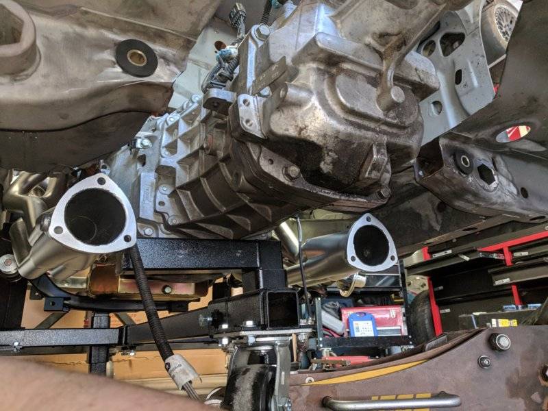

I have a plan for the transmission mount, basically copying what @Dragger40 did. Going to weld in a couple inches of the DOM tube in the torsion bar crossmember. That will hold the bushings and add stiffness after the center section was hacked out. Still planning to build a floor support over top of the trans.
1.5 o.d DOM tube fits perfect in the torsion bar crossmember.

I've got the transmission crossmember designed and about half done with the fabrication. Expect to finish that up next weekend. I wasn't able to get anywhere near 1 degree of down angle on the trans. 3 is about the lowest I could go without putting the driveshaft in the middle of the cabin.
After finishing up the transmission crossmember, I need to do the inboard relocation boxes and I can put the rear suspension in and make it a roller. The goal is to have it rolling by end of the summer so I can take it and get all the sheet metal professionally done. By the time Glamis season is over, they should be done w/ the sheet metal and I can start building for real.

Will you have room in your tunnel for the driveshaft adapter? It' hard to tell from pics but you may have to expand you driveshaft tunnel upward.
Just something to consider.
EDIT: I just looked at mine and yours looks about the same hight. I guess I did expand my tunnel a little... I just forgot that I did. Old age is catching up!!

It's pretty tight. I think it might need a bit of massaging. Did you go with a flanged driveshaft or did you convert yours to a slip-yoke?
I used a Driveshaft shop conversation. It has a round aluminum adapter. The adapter is about as big as the steel yoke on the transmission. BTW, if you use this setup, make sure that you line up the blue lines when you put it together and you won't have to to it twice. lol
