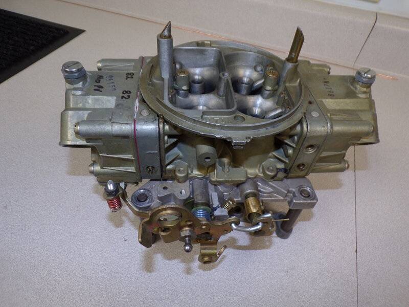

Must chose a carburetor to start with. In keeping with the theme there is the 4150 from Dad's NASCAR days in the 1970's. It is a Murry Jensen modified Holley DP with 1.400" venturies and 1.680 throttle bores. This carburetor took the 424ci stroker to right at 600 HP so we'll start with it and maybe swing to the 850 Mighty Demon and the 1050 cfm Demon RS later.
Was this Murry from Fuel Curve Engineering back in the day??
Okay. Did a quick research and it was Murray Jensen. Since Pop was building 357 ci NASCAR engines out of California it was probably the same Murray Jensen at Fuel Curve Engineering.
Some place we have a picture of him leaning over a carburetor at full throttle with his hair streaming down the side of his face toward the carburetor.
There is a small article in memory of him at the very beginning of the 2004 Edelbrock Catalog.
Murray was an awesome guy...very helpful! He did a carb for me back around 89' for my 69 440 Charger...I was 17. Then they moved and never heard from him again.
