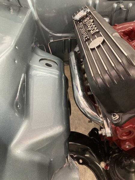

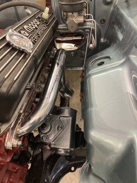

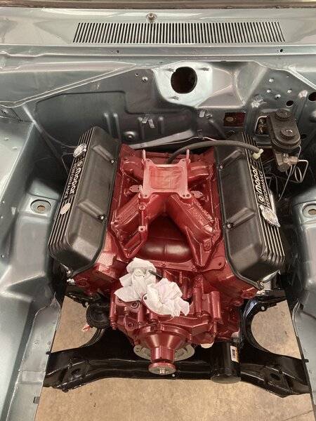

Put a 400 stroker (470) in my 69 Valiant. All I can say is if you use Schumacher shortie headers there is plenty of room.
I put a Manciniracing.com front engine plate and fenderwell headers. Easy peasy. Manual brakes, manual steering. Plugs and steering are easy as nothing is in the way on the sides.
