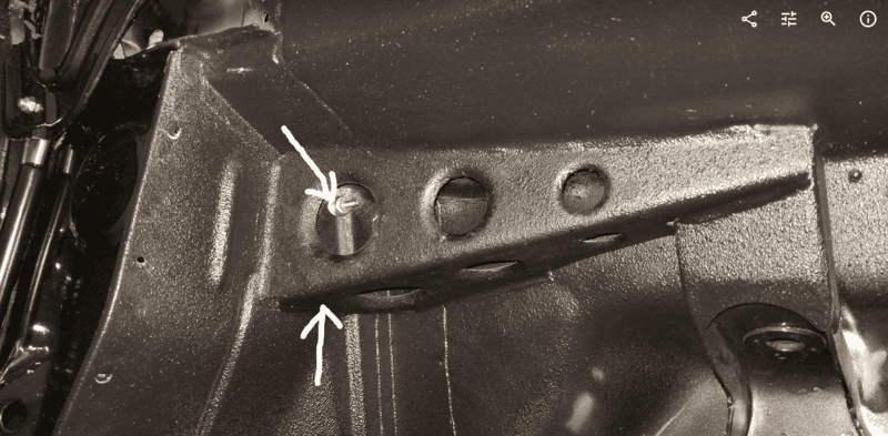

Of course 2 of the bolts came through inside the inner fender brace. Ugh.
The top one you can see the bottom one is in there you just can't see it.
Fun stuff.
