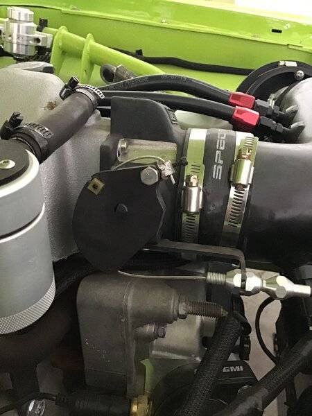

Looking for throttle cable bracket ideas, I came across this one.
This or something similar is what we will be running on our 6.1 with BBK throttle body.
The cable runs under the intake manifold.
I may have a couple other pics. I'll see if I can find and post them.
Here is another version.
These work with the BBK throttle body. Not the LS style.
Same idea mounted to a different location and a simpler execution.
Yes, this one happens to be a LHD car, thanks to one of our friends down under.
I really like the simplicity of this mounting location and the minimal fabrication.
