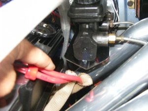

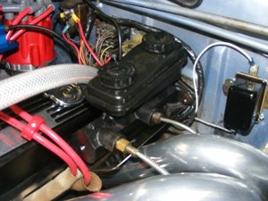

As you can see headers are in order, super heating fuel and brake fluid are just not a good idea.
A pic of my m.cyl upgraded to top 2 posts,also had to customize an adj.pushrod for the master.Hope this helps you some?

Thanks for sharing that, it does. I figured I will need to relocate to run a dual pot master. The single is on top of the valve cover by 1/8" as it is.
