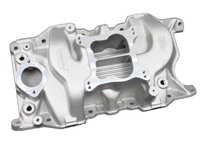

Any 318 four barrel intake will fit, including the original 273 4 barrel intake. 273's have the small port heads like the 318. I'd suggest the 500 cfm Edelbrock. If you upgrading other things like cam and valve springs, you can go bigger. New Intakes like the Edelbrock Performer should work quite well for what you want to do. It will also accept a Thermoquad or Quadrajet carb, so you will not be limited to carb size or style down the road. This assumes you have the stock 67 273. It is best to get a 340 throttle cable bracket and kickdown linkage, since the 2 barrel kickdown will not be long enough.
66FS,
Correct > An Edelbrock Performer #2176 or Weiand Action-Plus #8007 will do the
trick for a 'basic' 4-Barrel upgrade.
Both Aluminum Intake Manifolds will 'match up' with the stock 273 Cylinder Heads.
Weiand Action=-Plus #8007
The intake issue is not present on your year car/engine. The first two years of the 273 engine are the issue with intakes.
The above mentioned intakes are what your after. Carb wise, that 500cfm Edelbrock is a great idea or a sub 600 CFM Holley. 600 CFM is the max I'd go and not so willingly. If you can not source the original type linkage for the carb/trans, look to Lokar or equal for cables. There easy to install.
