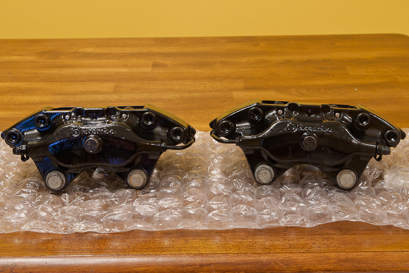

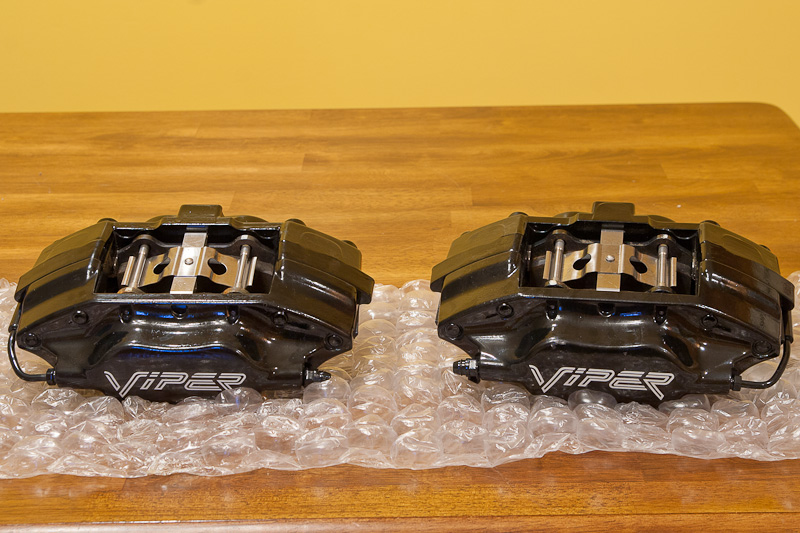

Nothing major to update so far. Collecting more parts. Got Viper front calipers on the way. Traded my early-style swaybar LCAs for a set of '73-'76 LCAs, which have been stripped and blasted, the edges hit with a grinder and stiffening plates welded on. Got '73-'76 drum spindles, required for the Viper calipers. Built a set of dollies to sit the car on while the k-member is out. So much to do...
Probably going to go with Firm Feel tubular UCAs and the poly front-end rebuild kit with 11/16" tie-rod setup from Firm Feel. Got a set of the Mustang rear brake caliper mounts from Dodgedifferent2.

There are plenty of Jeeps up here in the u pull it yard if your still looking for parts. How does the 1 go about swapping viper brake stuff on an a body?
Order for the '73-'76 urethane front-end rebuild kit with 11/16" tie rods and '73-'76 big-ball-joint UCAs placed with Firm Feel. :)
hope you got the caliper mounting bolts with your calipers, they're kinda pricey at the dealership. i had to cough up over 50 bones for mine, of course they (and everybody else here) passes on the shipping charge if its not in stock, so it may not be so bad where you are.
I did. :) Asked the seller to include the caliper mounting bolts. If you look at the pic that shows the back of the caliper you can see that the bolts are still there.

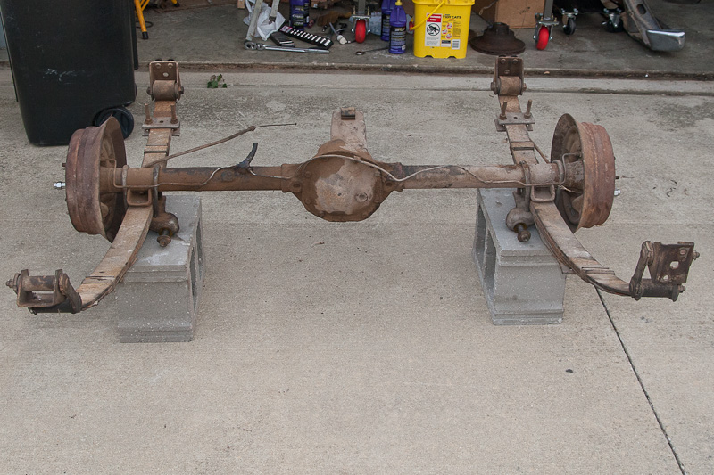

So I finally got the rear out and removed from under the car.
Anyone care to guess what rear this is?

7 1/4 with bell style drums. I'm sure someone can use parts from it or the whole thing.
Thanks again, Sedanman. :) I suppose I should clean the grunge off the thing and put it up for sale...

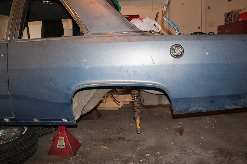

Got the rear shocks out last night...Didn't do much else. :(
