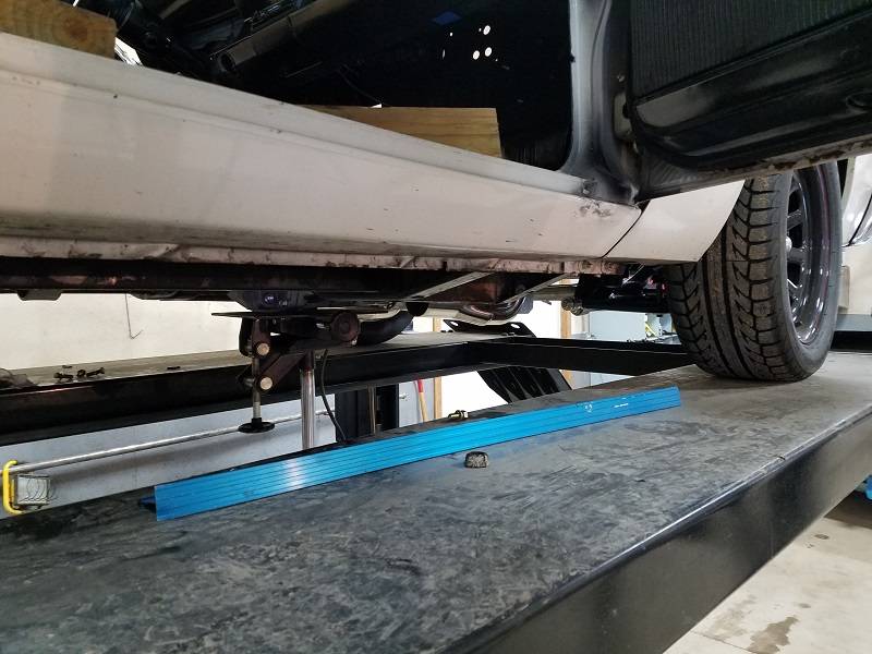

We put mounting tabs on the backside of the torsion bar mounts and then attached them to the subframe connector as well.
We also made a brace to go over the transmission and connect the original floor bracing back together.
