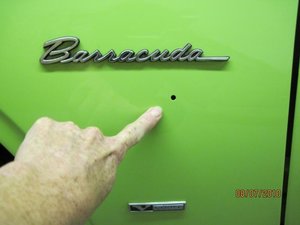

I just need to know what's supposed to go here in this empty hole on my driver's side fender.
My car is not a Formula S (at least nothing else on the car is) but the passenger side fender was from a '69 if it makes any difference. There are no empty holes on the p/s ...
... but the driver's side has me stumped.

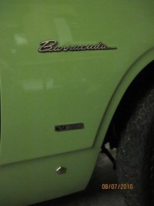

Hi, I have a '68 with a 318 that I got new. Here is where the emblems go. I haven't seen your V8 emblem on a '68. Is that the way you got the car? Mike

My 68 doesn't have that hole. Any emblem would require 2 holes.
Leanna, I will have to look around and see if I have a better picture but hat is where my 68 had the original v8 emblem mounted. Here is the only picture I can find of it now.
Here is the correct hole placement for the fourmula S emblem.

It looks as if your missing a hole. You need one to the left of your existing one for a correct 68' V8 emblem. The emblems you have for V8 are from a 67'.

You may have had 67 fenders on there....or they were drilled fo rthose emblems. The only other thing that went in place of where a 68 V8 emblem is a fish for the slant 6 models.

Do you know what engine came in your car originally? If it was a slant 6, there would be the fish emblems (like the trunk) under each script. If it was a 318, then the V8 emblems like I am going to show you here.
I'm thinking someone added the lower V8 emblems. Did someone swap a V8 into a slant 6 car before you? Maybe that was their way of bragging... who knows..

Your hole looks like it may be one end of the single fish emblem used for the /6. It is too far back for the Formula S and the fish/V8 emblem.
