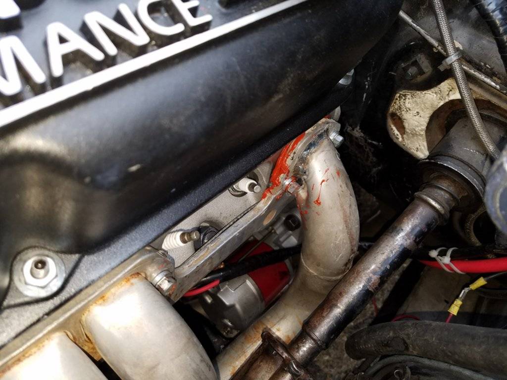

unload car....in 4 passes car runs a best of 10.46 at 126 mph...great 60 fts...1.400...and 1.402...but....3 rd pass we hear a exhaust leak...tighten up header....still leaks.....come back will giant header leak.....NO. 7 header tube is blown all to hell....see picture....after discussion,,,,fellow racer offers to take it home and weld it back together....header come off very easy...could not believe it...but Qa1 k member and no torsion bar sure helps....I guess all the money i spend on front end pays off..
guy does a beautiful job of welding it back together.....get the header back on in record time..did not have to take starter off either...only had to not tie rod and pitman arm off center link. fire engine 10 minutes before 1st time run...the guy is Justin Crosby from Lancaster Cal....just a shout out for him.....
