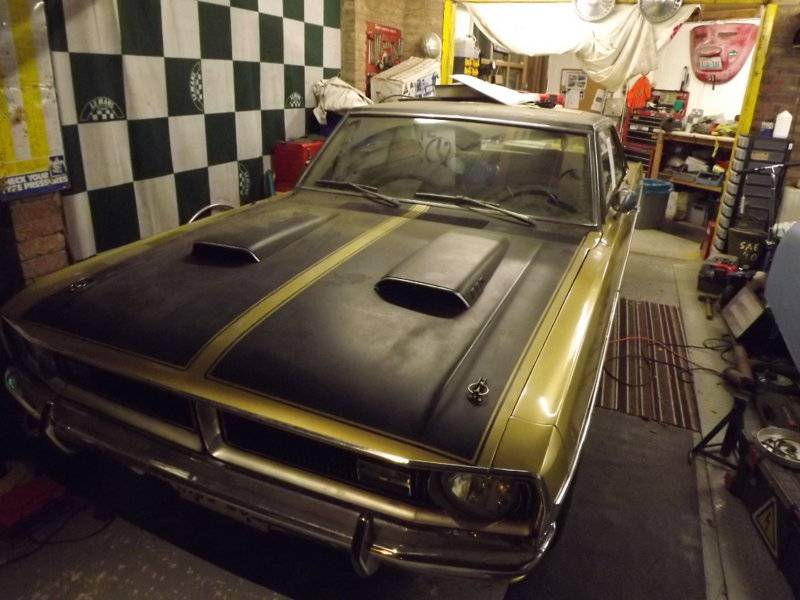

I've moved onto sorting brakes, wheels and tyres.
Re bled all the brake with fresh fluids and got a nice firm pedal. As with a lot on this car, discs, calipers and all rear shoe gear looks new.
I've sorted through my stock of tyres and come up with 215/70/14 rears and 195/70/14 for the fronts on 14 x 7 rims. I'll upgrade to 15" when I find a decent sets for sale at a swapmeet.
Steering arms reconnected and all 4 wheels back on the ground, first time in about 3 years.
